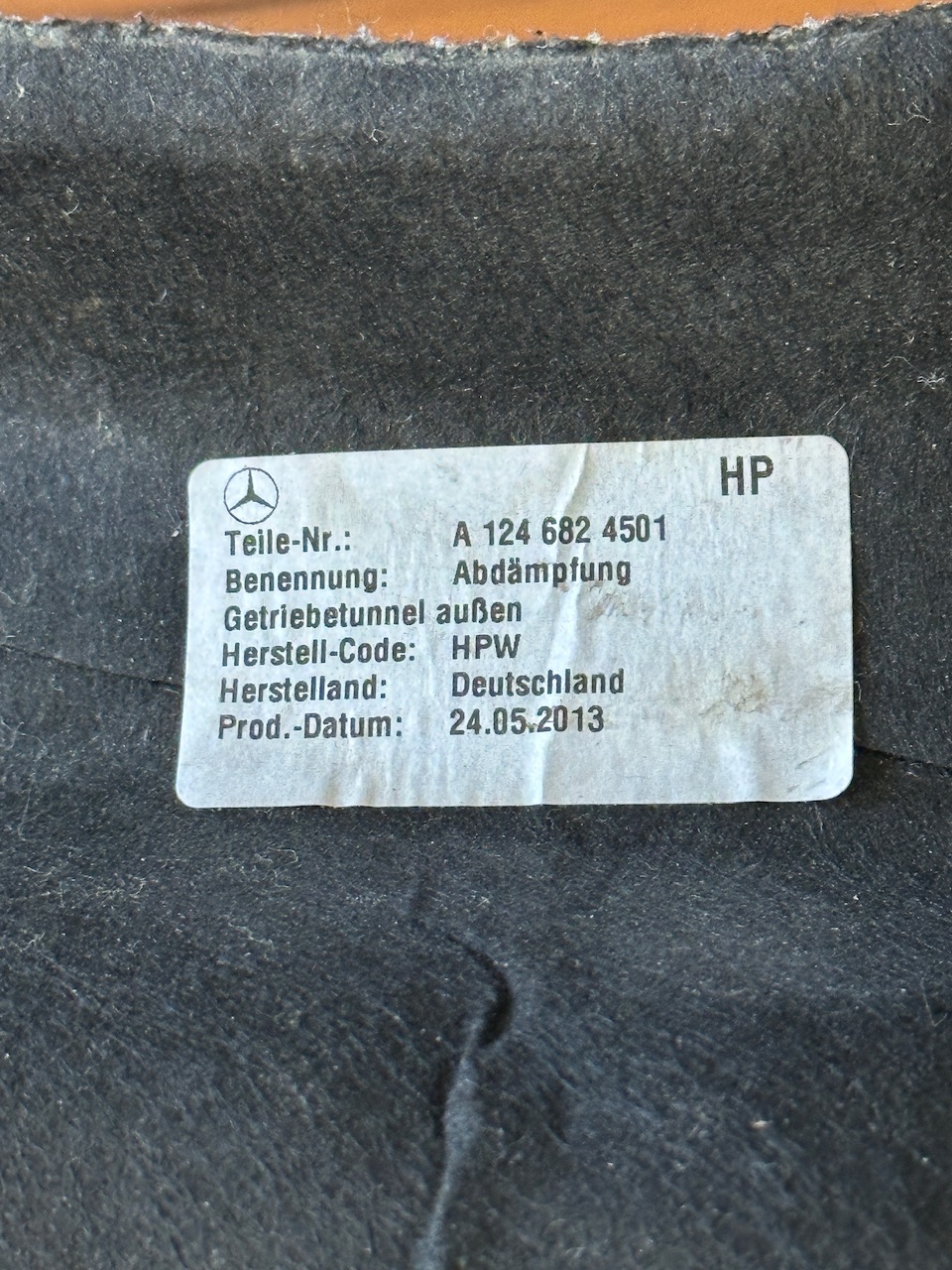

NLA for a long time but I believe @gerryvz had offered a while ago to make his NOS unit available for someone to replicate the transmission tunnel insulation and for them to make those available for others for purchase. Can’t find the thread right now and since this was a while ago Gerry might not even be open to that idea anymore.

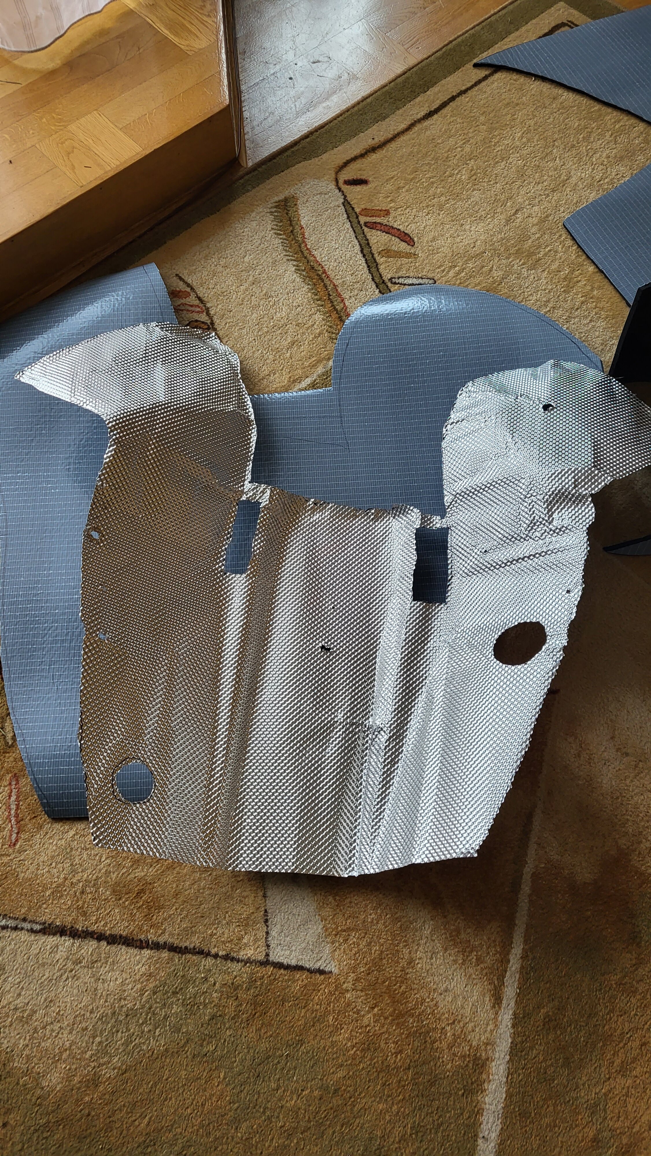

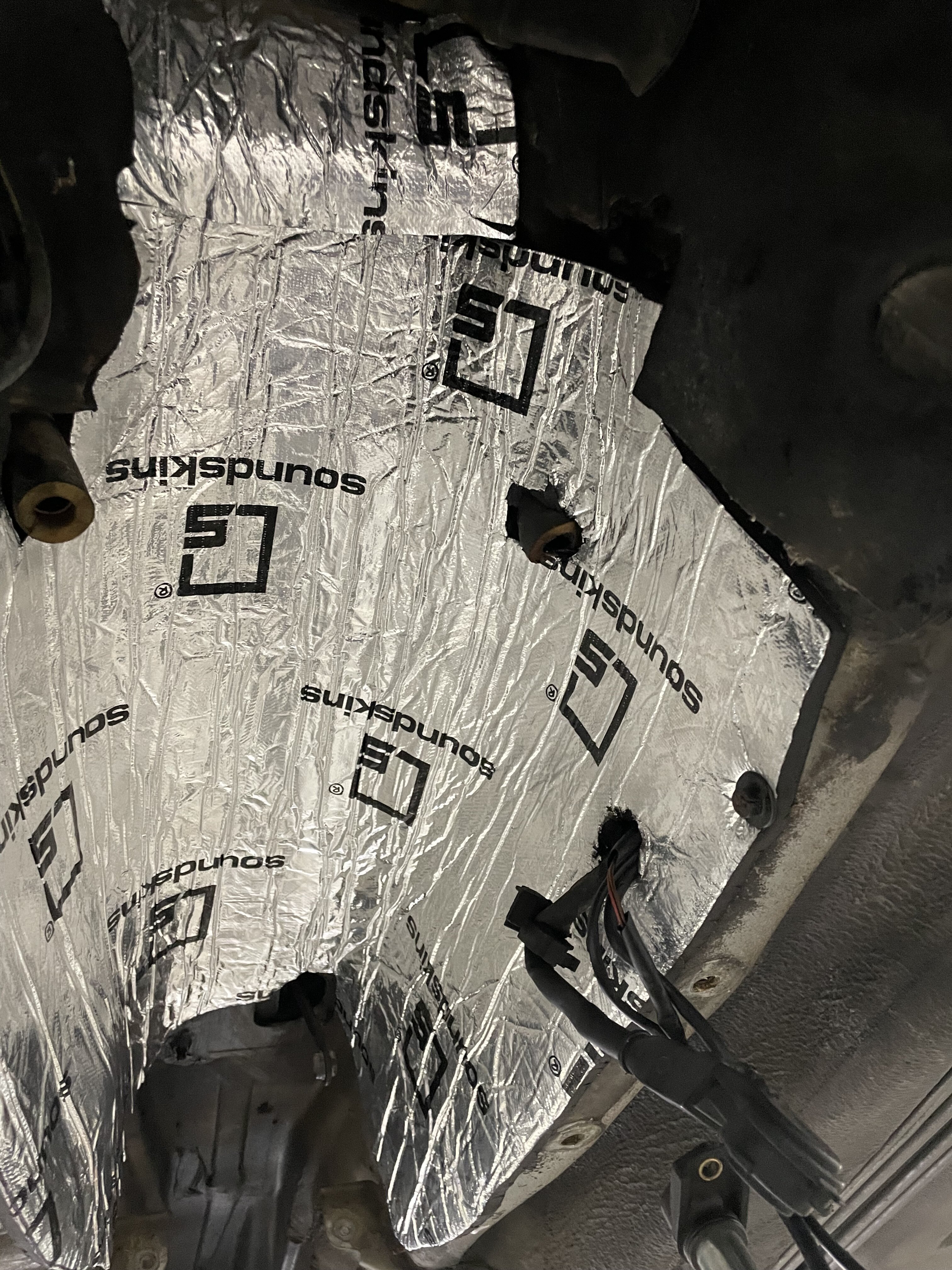

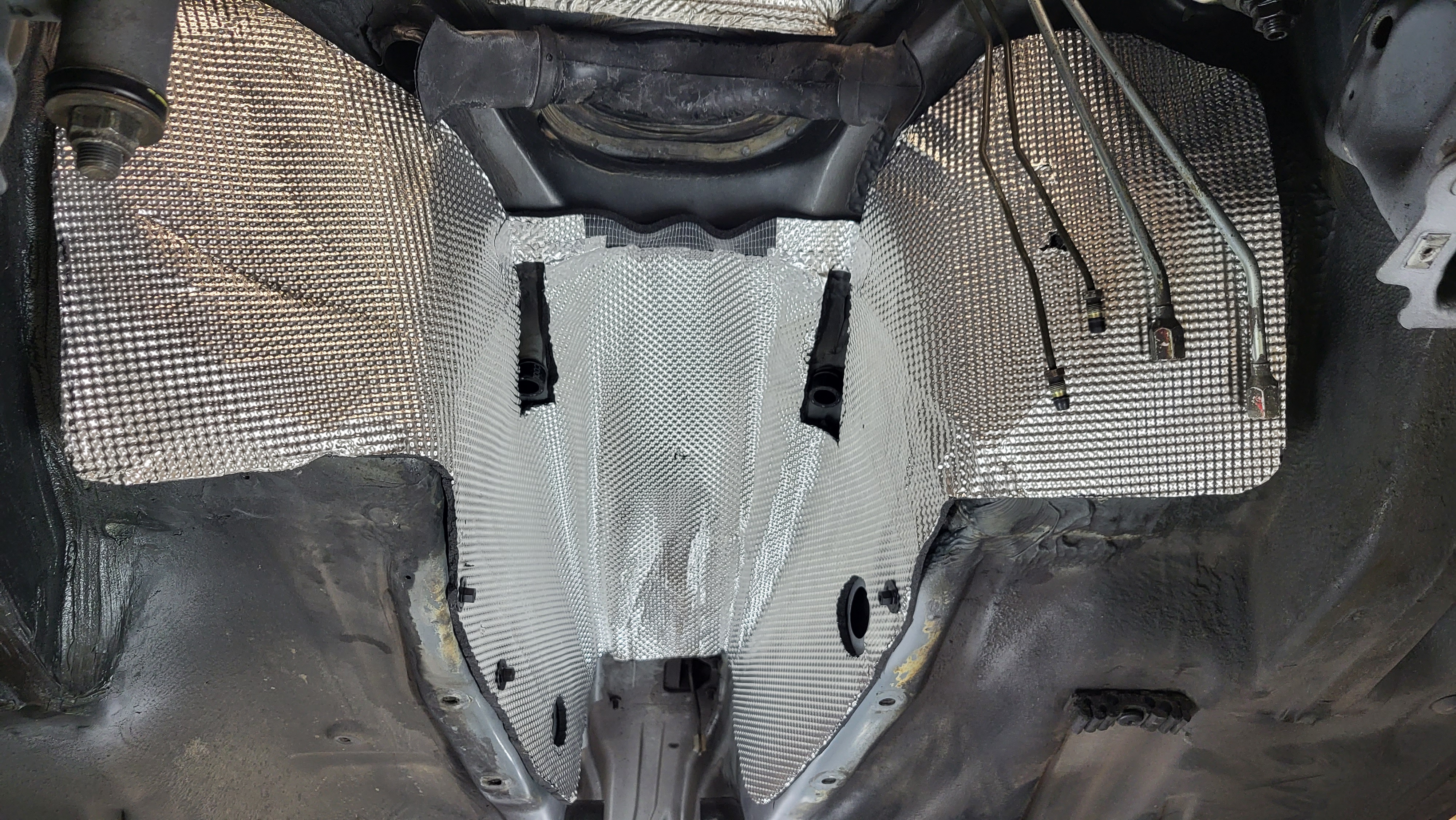

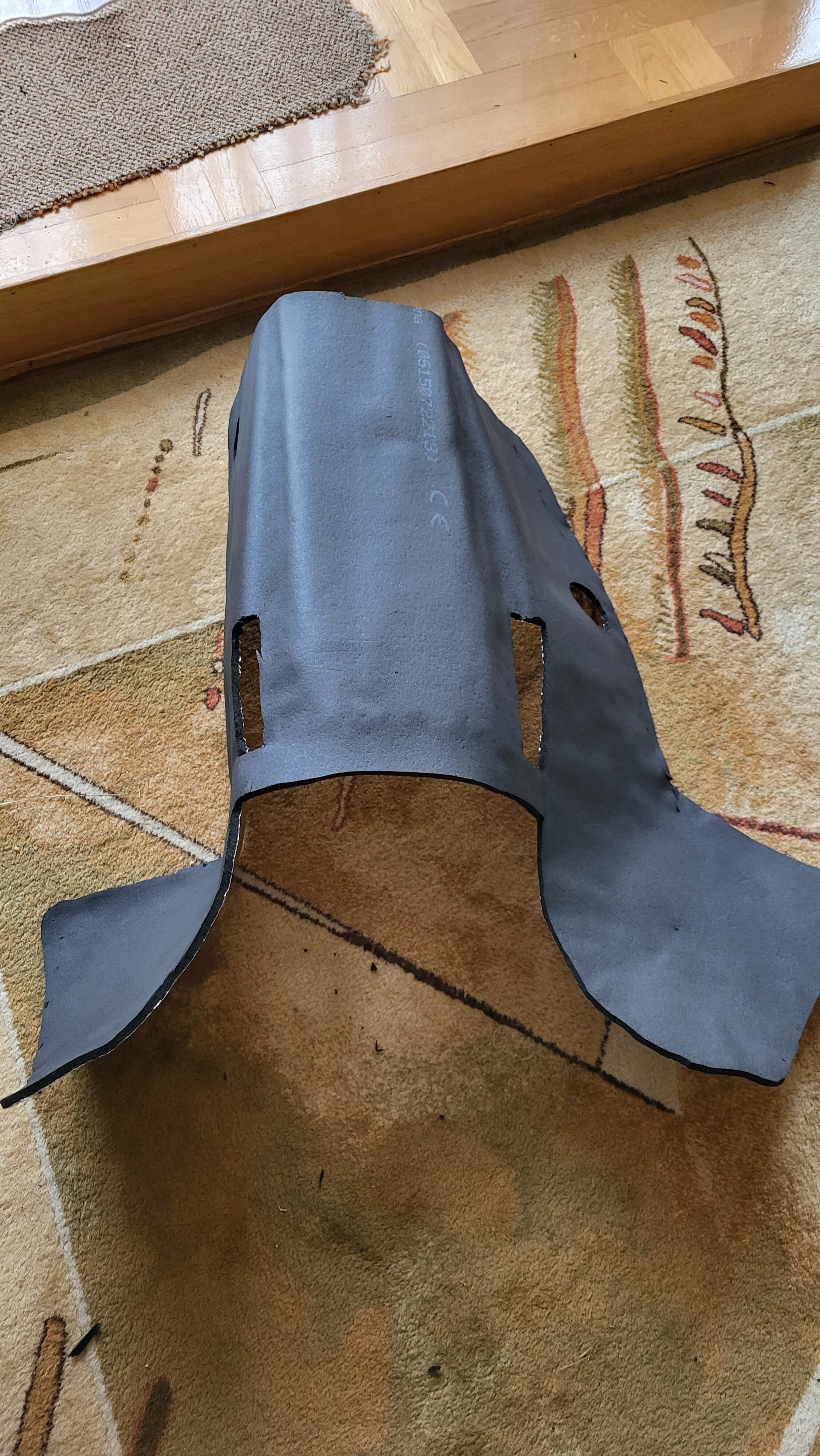

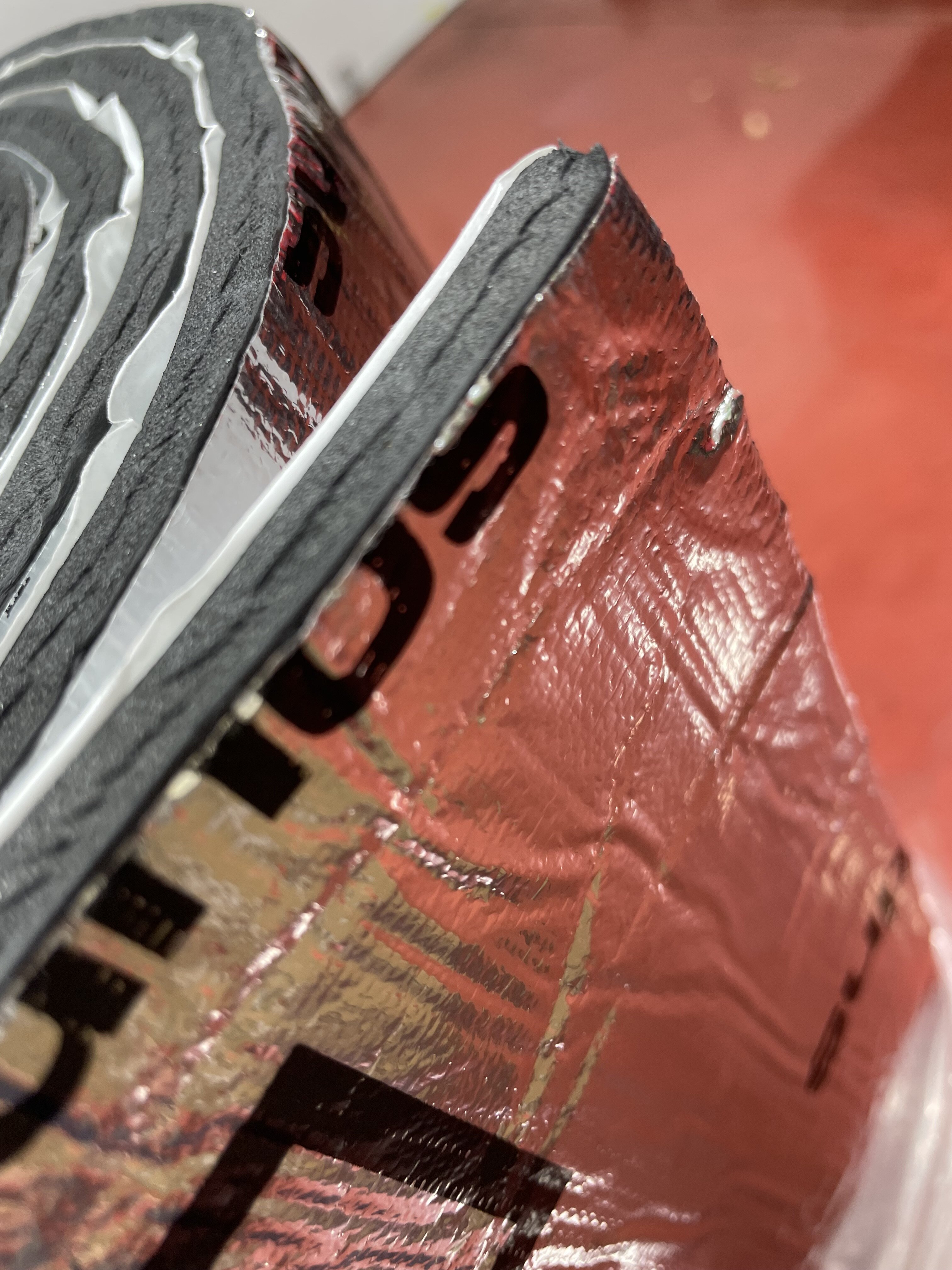

I made one myself from aluminium and polyurethane foam. I Suggest you to do the same.

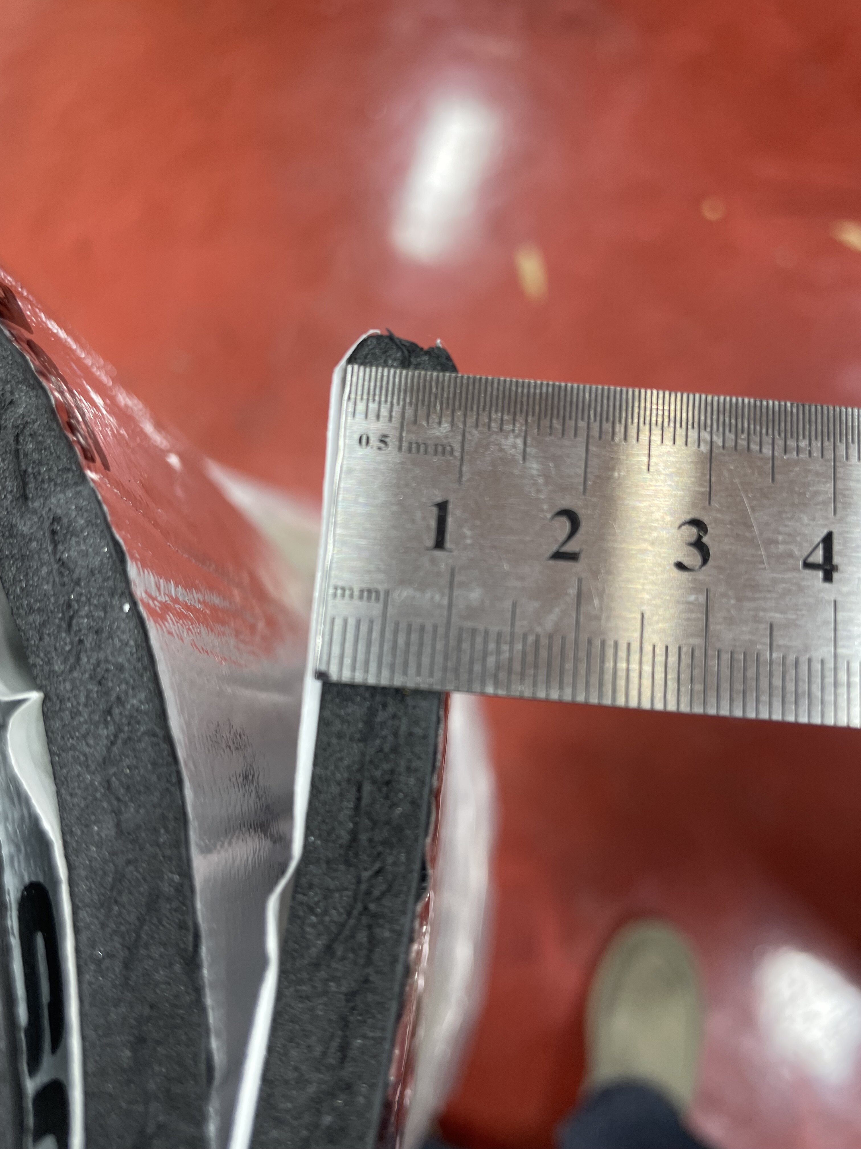

Yep I have researched and am going to try this product and cut it to size,

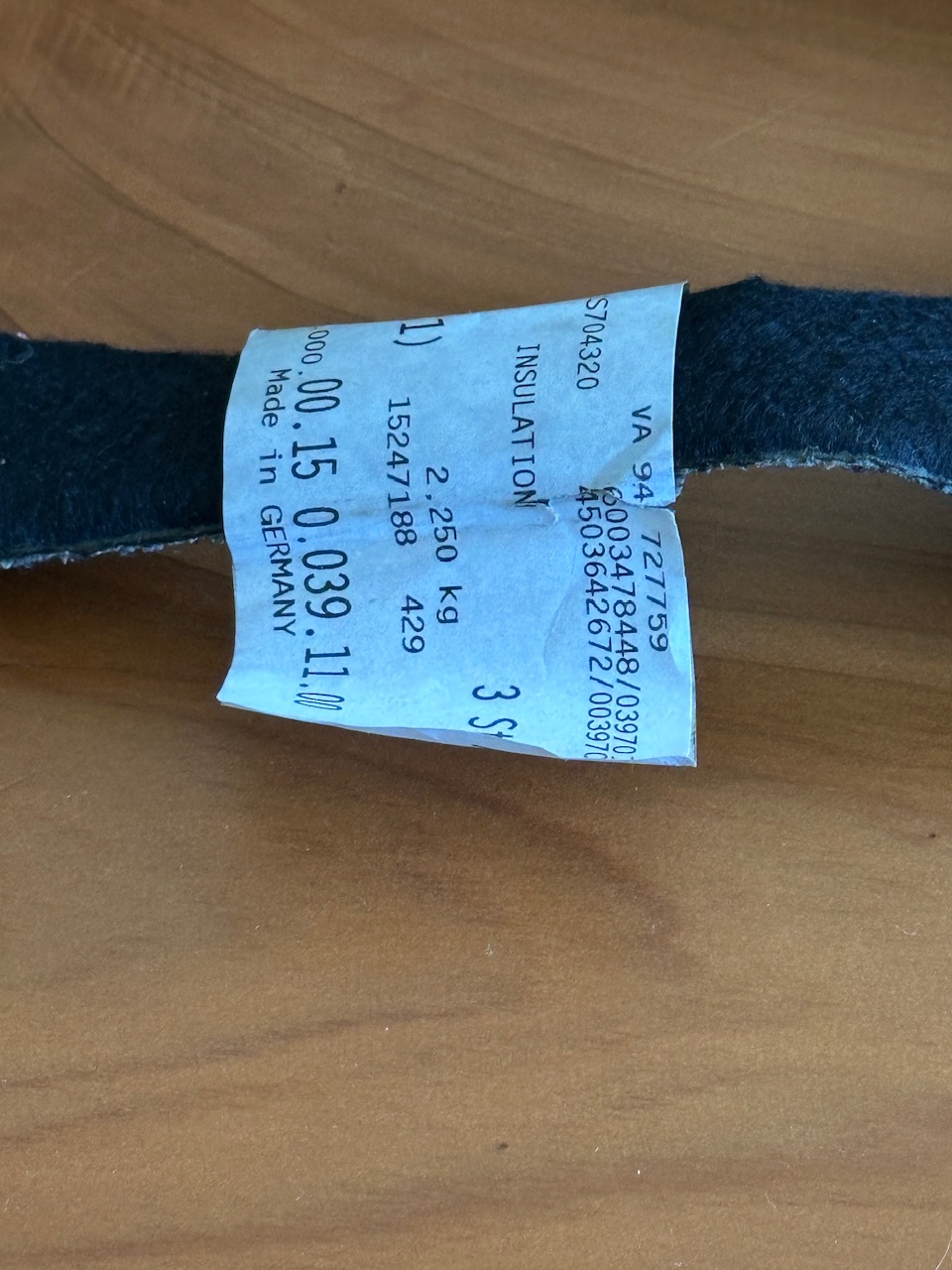

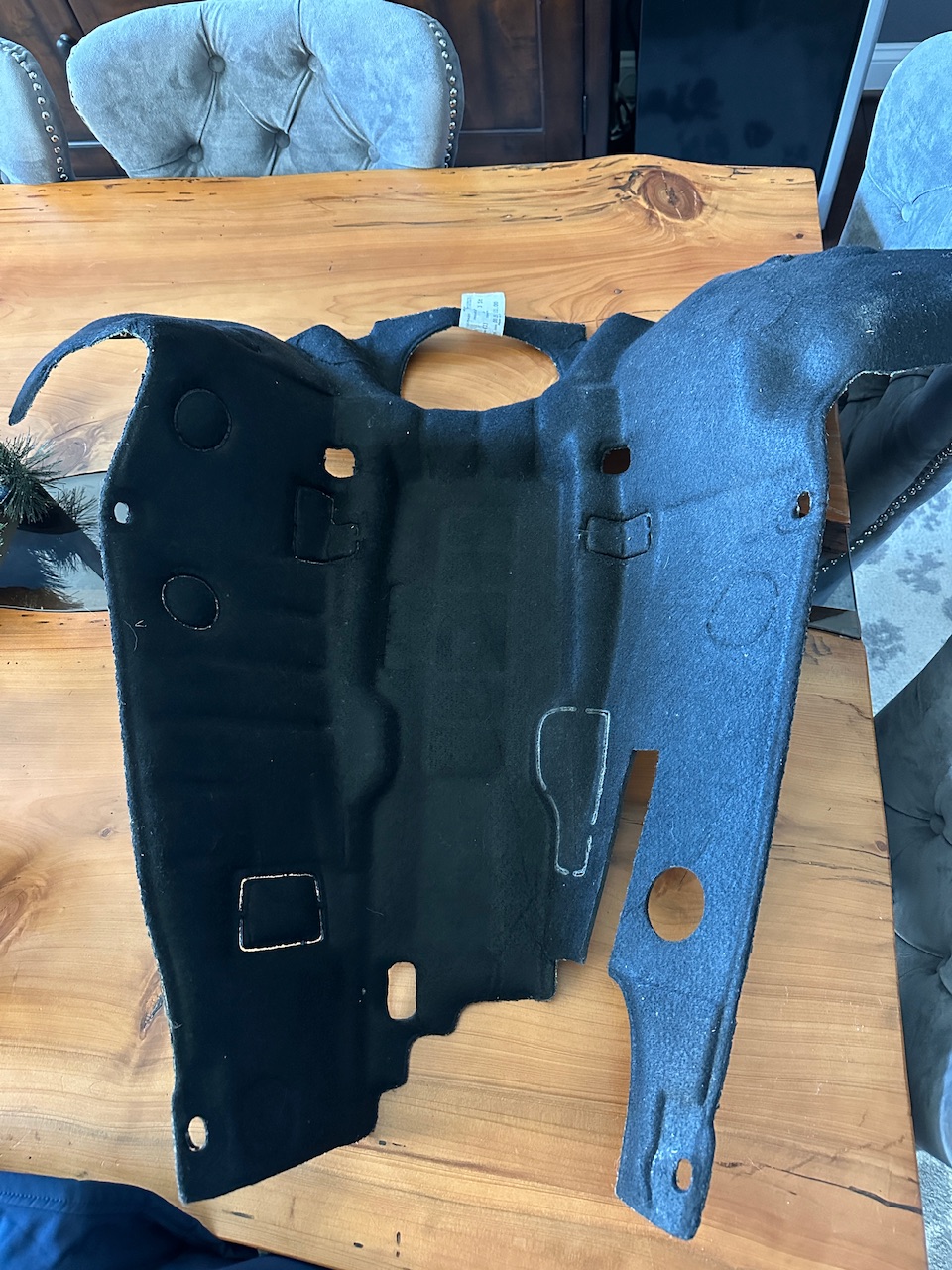

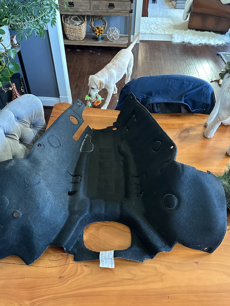

I should probably take a piece of newspaper and create an exact template for the blanket from my NOS unit. That way it could be made available for anyone on this site who wants to create their own.

I can get to this later today (evening) I think. I can put my hands on the blanket easily as it is readily accessible on the top of one of my basement shelving units. How best to get you the template? Send by mail?

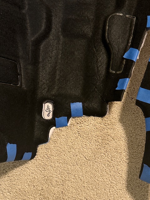

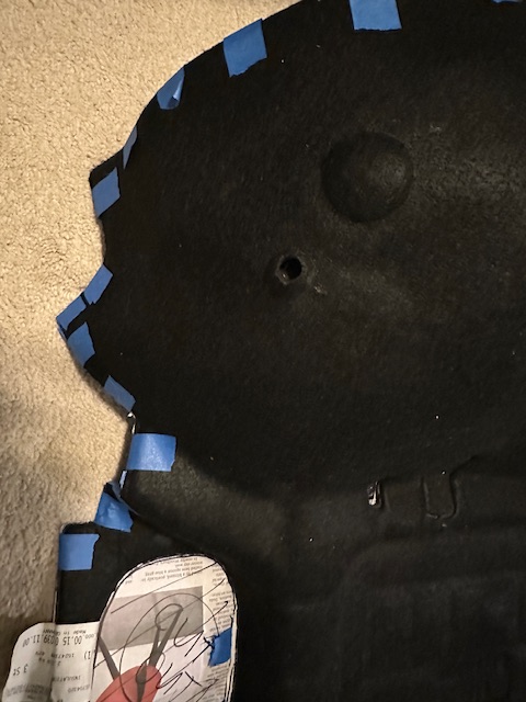

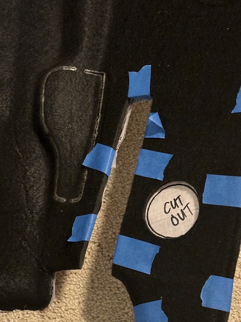

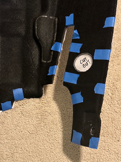

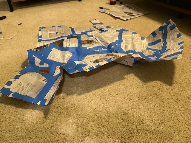

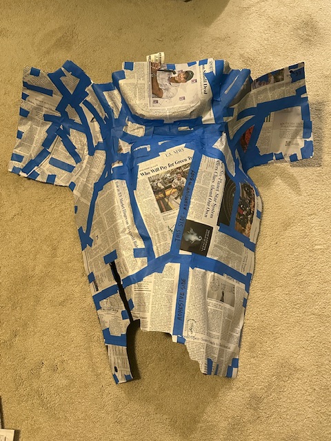

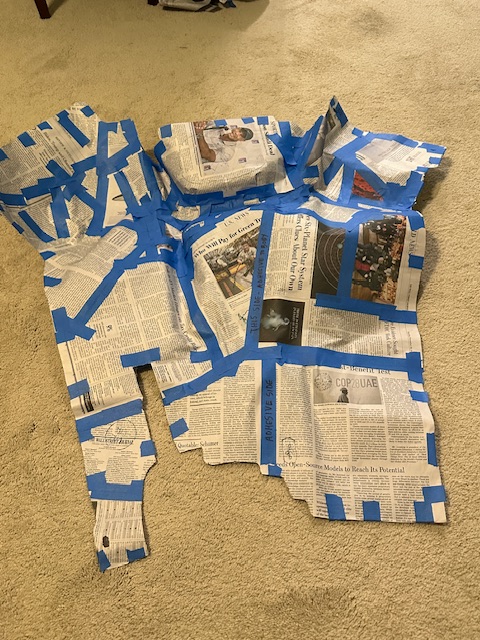

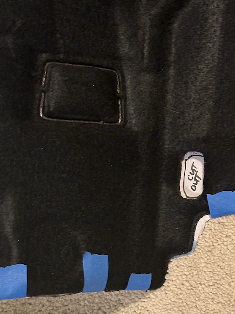

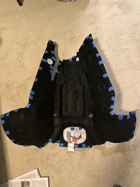

Creating this template has been an absolute nightmare. I was a full hour into it, and had to start over. This is because the blanket has major amounts of complex curves. Large sheets of newspaper taped together didn't adapt well to these curves.
So I restarted using much smaller (8.5 x 11") sized sheets of newsprint, which I tape together and which captures all of the curves much easier. You can't flatten out the transmission tunnel blanket due to it being "pre-molded" in a specific shape, so you have to attach paper to catch all of the curves and such. There are also plenty of holes in it (for various components) as well as perforated holes that may or may not need to be punched out if needed when installing. I'll do my best to capture all of these in the appropriate places.
Right now I'm two full hours into creating the template, and probably have two more hours to go; then go to the post office to mail it before 5 PM today.
Not the funnest project. I'd rather remove my E500's radiator or replace the front rotors on my 560SEC......

So grateful for the effort you are putting in. I did look at your pictures and had the same thoughts about the curves. I was already thinking that it is a good job that the padding I have ordered has adhesive. This means we can get a a template cut and the adhesive will allow for the pad to take shape sticking to the underside of the floor. I will make a video/pics of installation of pad.

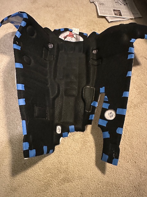

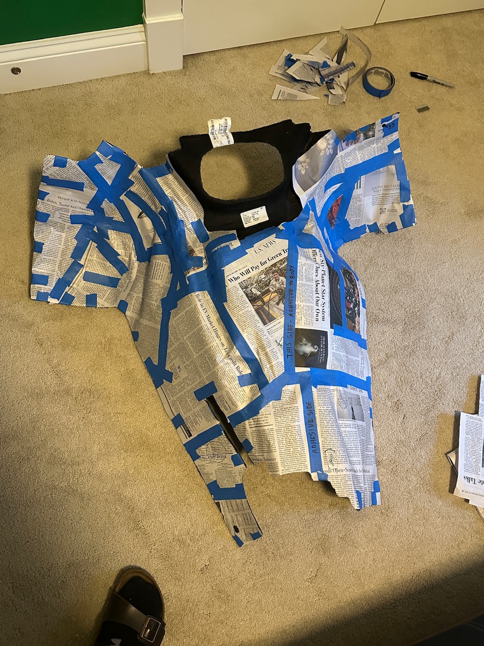

Done. 5:30 PM. 3.5 hours + 1 hour for the first attempt.
Before the first try …
Finished product:

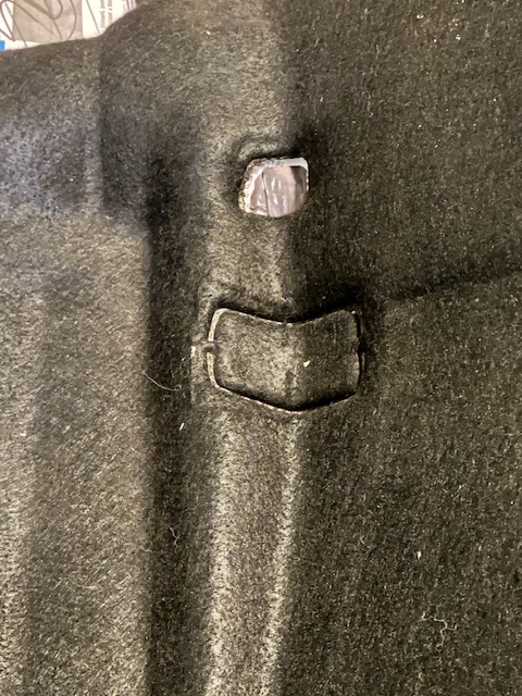

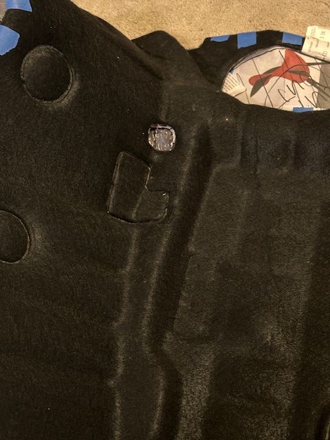

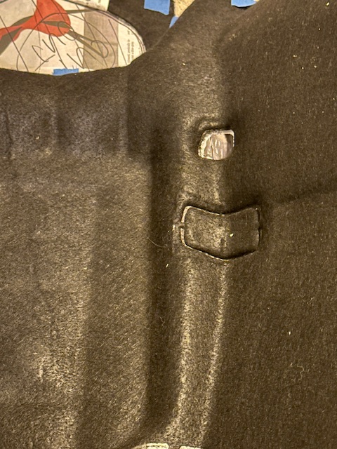

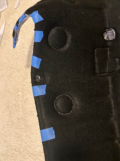

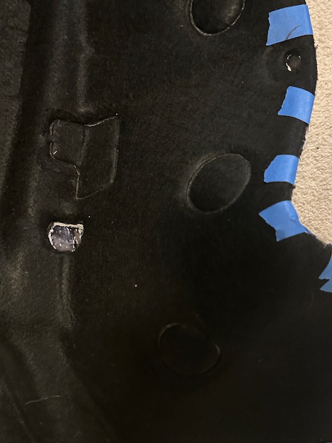

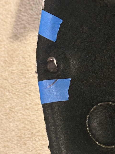

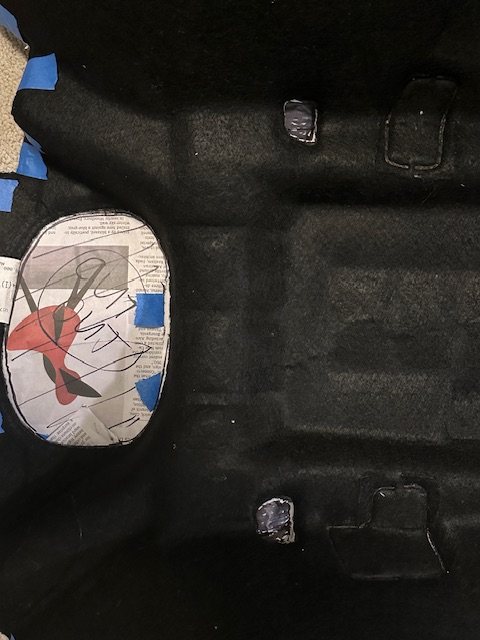

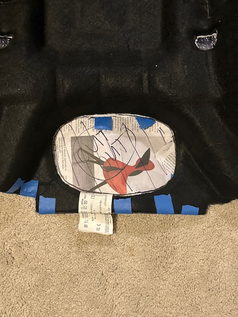

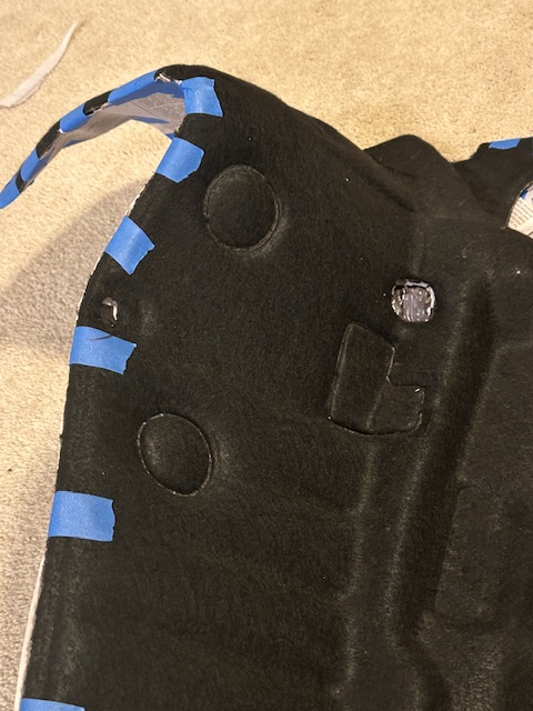

Some close-up photos for reference of the holes and perforated cut-outs. Any thru-hole I marked either in an outline or black ink if small.
IMG_9293.jpeg IMG_9294.jpeg IMG_9295.jpeg IMG_9296.jpeg IMG_9297.jpeg IMG_9298.jpeg IMG_9299.jpeg IMG_9300.jpeg IMG_9301.jpeg IMG_9302.jpeg IMG_9303.jpeg IMG_9305.jpeg IMG_9304.jpeg IMG_9306.jpeg IMG_9307.jpeg IMG_9308.jpeg
From memory, the important holes are for the 2 heater box drains (foam tubes) and the O2 sensor connector. Many / most of the other locations are not used on the 034/036, which seems odd.
So out of the roll of material I got I managed to cut 3 extra beside my own . I have to be honest to save time I did not use the full template on my car because had a small window of time to install, and I sort of faced a significant labor bill to install the whole piece. So I cut out the old perished bits and added what needed to. The pieces I cut using the template are full shape. The material is soft enough to mold into the curves very easily. I left a little extra for trimming down. You will need to cut holes for AC drain and wire plugs. but that is easy once you are installing. use a craft blade. Clean surface with a spirit to degrease before sticking down. I only have 3 pieces and I don't really want to buy another role pf this material at $300. I do have the template given by @gerryvz for the next person.
