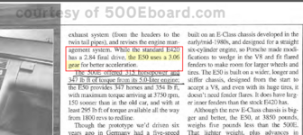

Do you know if the wagon has 2.82 or 3.06 rear axle ratio, btw? I believe the E50 was 3.06 but there are so few E60, I'm not sure what AMG did on those.

2.82 on the wagon. I believe the sedans also had 2.82. I know of one that was converted in 1996 that had one so safe to assume perhaps that's what they all have.
Resistor plugs are AOK for the distributorless / coil-on-plug M119.98x engines with ME 1.0 engine management. You used the correct plugs.
I would have sworn the E50 sedans had 3.06 gearing... will need to double-check on that. The stock E420 (210.072) did indeed have 2.82 gears.

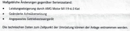

I just saw 2.82 on some paperwork and came to a conclusion
If I actually translated another one of the documents to begin with...second bullet point translates to "Changed axle ratio."
Above is for WDB2100721A233920

Looking into engine numbers from another thread, I noticed yet another issue with my AMG Conversion Confirmation. The AMG engine number doesn't even match. 992724, not 99724
I'm sure this AMG Classic confirmed "E 42 Wagon" with engine number "99724" will give buyers great confidence. What a waste of $900 :facepalm:
