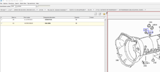

@JC220 and @500AMM are both correct. It's a test port, and uses an aluminum crush washer / seal ring.
It is in the EPC, but not obvious as it's shown on the opposite side, because there is the same plug on both sides of the transmission.
