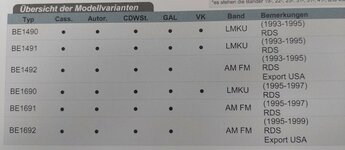

As far as the 512 radio goes: I can not be sure, but from the attached Becker model overview (for "MB Special" from that era) I suspect it originally to be a Becker BE2210 or BE2211 (those were the top models for MB Special), both are still easy to find online. But may be other readers can be more precise.
