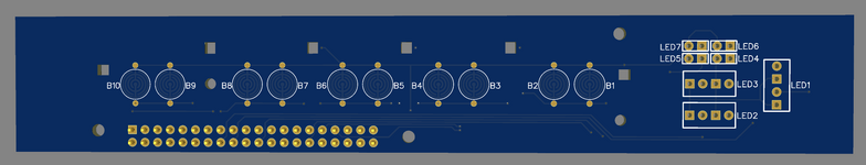

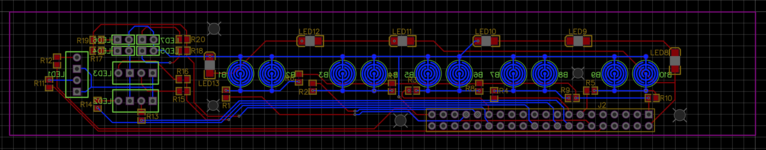

Quick Update -- In the circuit diagram I added a provision for the 6 tiny little LEDs that backlight the buttons. I also ordered these little LEDs from Mouser (a couple of cents each) so that when I receive them, I can add them to the breadboard and test.
Then I watched a bunch of youtube videos and learned EasyEDA, and I laid out the PCB. The trickiest thing was (a) having to draw my own footprints for some of the components and (b) figuring out how to do reverse-mounted (bottom access) LEDs. Reverse mounted LEDs are for the 6 tiny LEDs that backlight the buttons. They are mounted on one side of the board, but shine down, through little holes in the board so that they can light up the semi-translucent rubber/siliconized/whatever buttons.
So on the hardware side, all I need to do is verify that the reverse mounted LEDs work as I intend them to (6 in total, 2x 3 mounted in series without any resistor). I might have to fine tune it a little bit by adding a small resistor and / or change it to 3x 2 mounted in series with a resistor.
After I prove that all works, I can send the PCB design out for fabrication.
