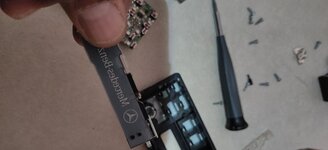

I have a 1492 that I just removed and gave a thorough cleaning with deoxIT, because of the erratic volume problem.
I was able to disassemble it, remove the tape mechanism, and clean the volume pot completely.
Reassembly was pretty straightforward; the volume issue is resolved, and the tape and radio are working great. I have not checked out the CD player in the trunk yet.
I considered adjusting the playhead but decided to leave it alone.
It's a great little unit.
