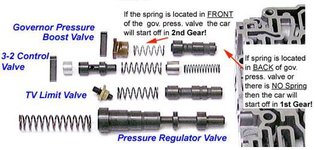

You can modify your existing.
Locate the governor pressure boost valve. The spring is in front of the valve, the car starts in second. Remove the spring altogether or place the spring behind the valve; then it the car will start in first.
This does not work: ^^^
1) If the spring is removed, the car will start in 1st, but will "skip" 2nd gear. It's insanely annoying. I bought a car with this modification and it drove me bananas.
2) AFAIK the spring cannot be placed on the opposite side of the valve. A different valve (and spring?) is needed, which is found in the .034 VB, and not sold separately. I'm not positive if the valves are interchangeable; I need to take both VB's apart and compare, and get photos...
