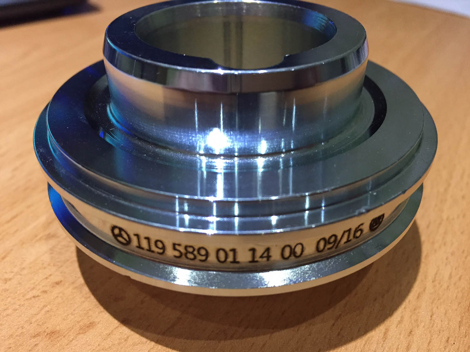

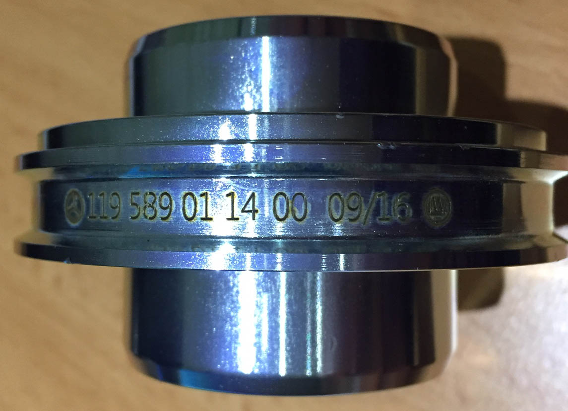

The OE dealer tool is p/n 119-589-01-14-00, available for ~$100 from discount dealers. You missed out on a Miller 9101 a couple weeks ago for $50 (look at completed auctions on eBay). Might find one cheaper if you have time to wait for a good deal. Measure the current position of your old front seal BEFORE removal. Factory position was often ~1.0-1.5mm inward from the face, and pressing the new seal in either flush or in 3.0mm might not be adequate to ride on a virgin section of the hub. Last couple I did, I had the seal protrude from the face slightly so it was 2.5-3.0mm away from the previous position. YMMV, etc.

119-589-01-14-00 (or Miller 9101) is the tool for FRONT crank seal. It will install flush or inset 3mm (click here for pics showing how to use it).

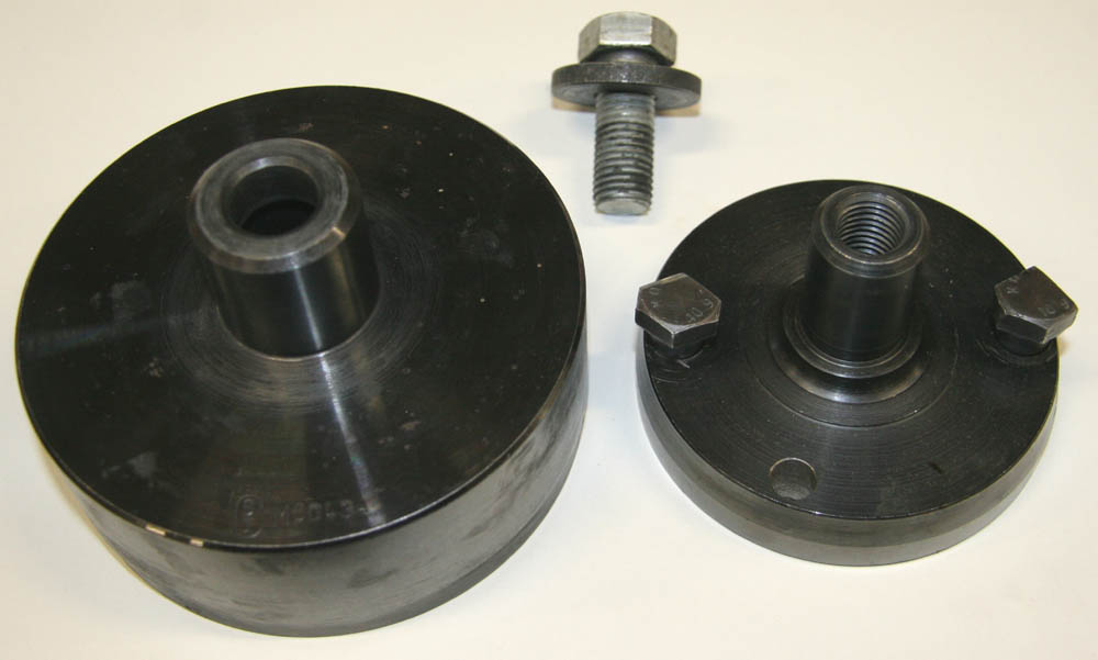

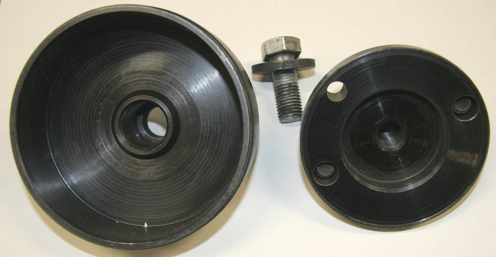

117-589-00-43-00
is the tool for REAR crank seal. It is meant to only install the seal flush, and cannot inset, AFAIK.
117-589-00-43-00 is the tool for REAR crank seal. It is meant to only install the seal flush, and cannot inset, AFAIK.

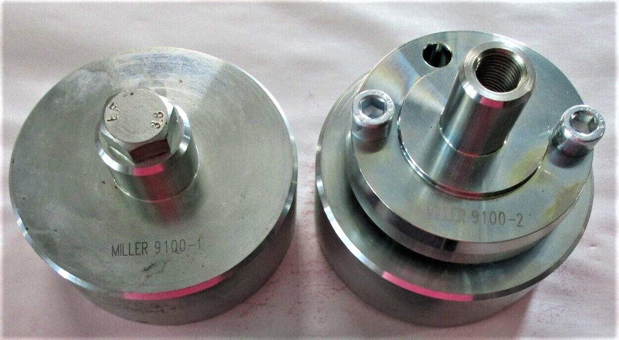

I was browsing and came across a Miller 9100 rear crank seal tool, does it fit the M119 or does it just have the same design?
(I thought if 9100-2 is split, that press plate/flange can be used inside 9100-1.)
Miller 9100 will work with the smaller 93mm rear crank seals on many 4/5/6 cylinder engines. It is equivalent to MB tool 111-589-08-43-00.
