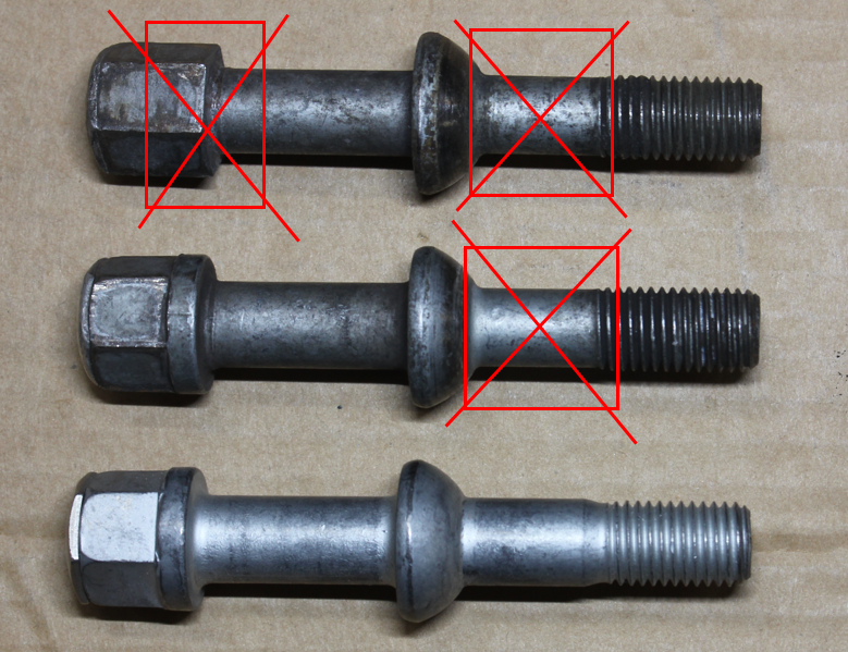

You can get 5 and have some spares...
The bolts shown above are for a W210 and are not the correct length for a 500E/R129.
500E uses a 95mm lug bolt:
Additionally, there are 3 different variations of the 95mm lug bolt. Early versions were used on some 107/126 chassis. Only the bottom one in the photo below is correct. Note the shank is larger and there is a round area at the base of the hex flats.

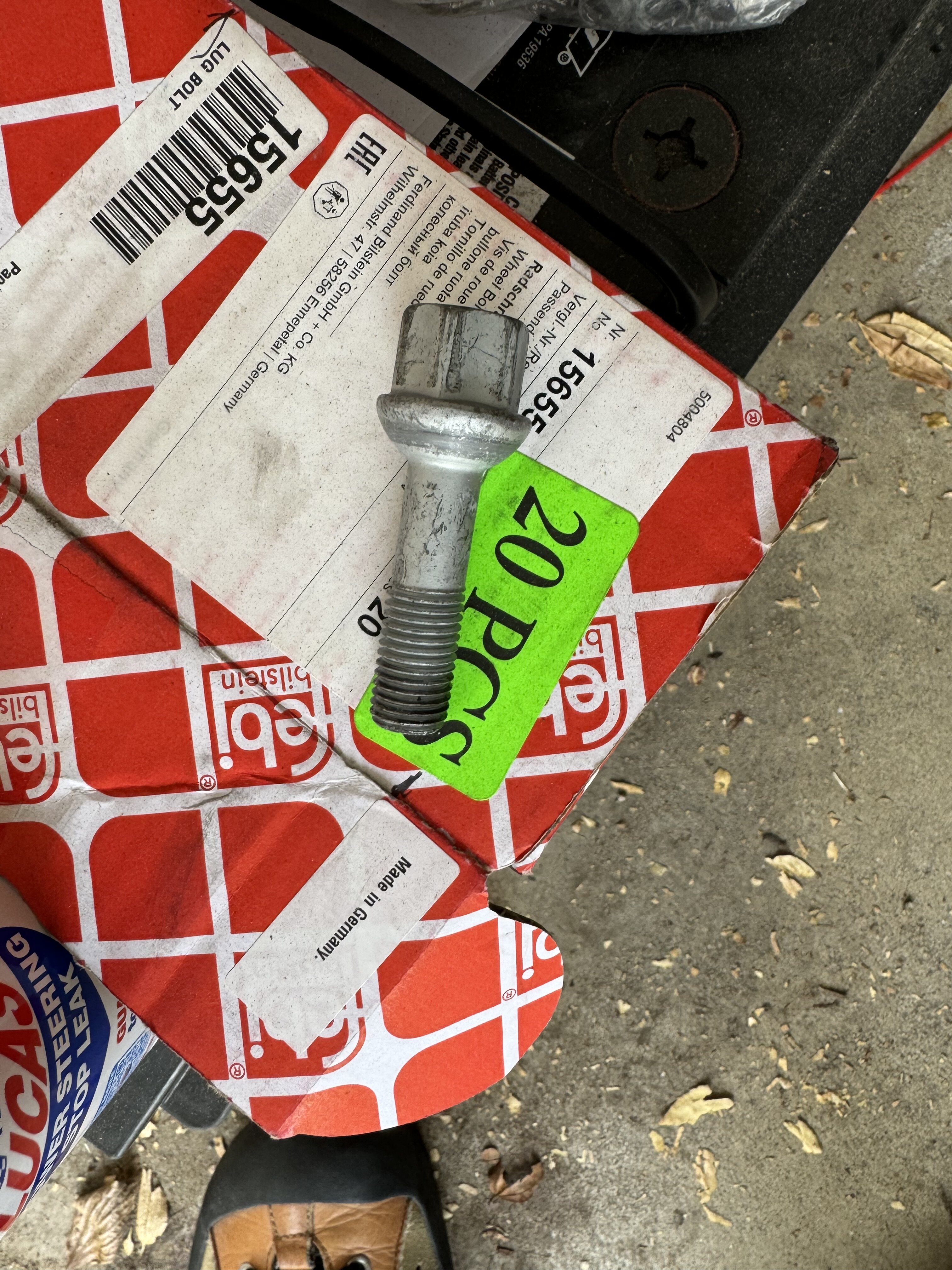

This is what was on them before. The seller found them in the garage. So I believe I’m good for now! Great guy BTW.
And what is the correct lug bolt for a set of square 18” monoblocks?
You still have not stated what offset / part number the 18-inch "monoblocks" are. There are many different versions of "monoblocks". Some use different lug bolts.
