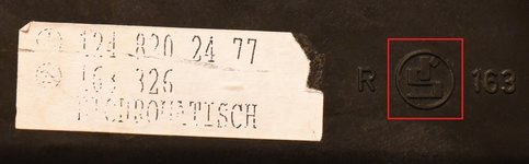

Went to check out my rear taillight assembly last night to replace a broken fog light bulb, and noticed that it's not the bulb that is broken, but the bulb housing itself that is broken and needs to be fixed.
I have illustrated the problem in the photos below.
In the blue circle, you can see the working bulb housing with the metal contact plates; however, if you look at the red circle, which is the rear fog light bulb housing, you can see that the metal contact plate has been either ripped out or de-soldered by someone.
Frankly, I don't know how this happened (not sure what the previous owner did), but it is quite a mystery, and I don't see how it could possibly be broken off in the first place.
What I need help with:
I'm looking to either fix this myself with a DIY guide, find someone to fix it for me, or find out how to order an original 1994-1995 W124 Euro E500 taillights assembly, either order an OEM part or from the original supplier.
If not, perhaps someone is able to fix this if it is a difficult task, as my experience with fixing this sort of thing is lacking.
Basically, if anyone has any idea or experience with this, I would be eternally grateful if we can work out how to solve the problem.
I have also included photos of the P/N on the back of the assembly, and if anyone knows who the original supplier is (there is a logo that I cannot identify), or know of a place to order a replacement, that would really help out.
[1] Blue circle = working housing, Red circle = broken fog bulb housing, lacking the metal contact plates
http://i.imgur.com/bMBMUxW.jpg
[2] The P/N appears to be A1248202477.
http://i.imgur.com/VqDK0HY.jpg
[3] Recognize the OES manufacturer, or know of a way to order it?
http://i.imgur.com/ClTZAZI.jpg

I recommend just replacing the entire taillight bulb housing unit (the interior portion of the taillamp that you're holding). If you like, I saw a pristine set of US 1995 E320 taillights on a car at a local wrecking yard, but I won't be able to get there until Sunday morning to get it, if you want it. I would be happy to sell it to you for my cost (which would probably be around $20) plus shipping, if you wish. I have to go back to that yard anyway for something else, so it would be no problem to score the interior bulb housing, or the complete taillamp assembly, for you. They would be the same price as car as the yard is concerned. I almost snagged them but thought to myself that nobody on the forum needed any taillights at the moment...
I've sent a PM!
