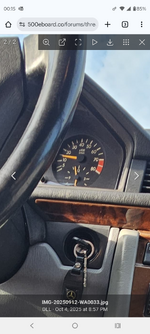

I'm guessing that from the red line being at 7000 that it's an early m104 with the CIS, I have a manual in my 300SL-24 and it's a blast.

We used a 400E cluster (bought a parts car just for that) with a Dakota Digital adapter, swapped back my original 7K rpm Tach. Yes, M104.980 engine with CIS & distributor (maybe EFI later).
