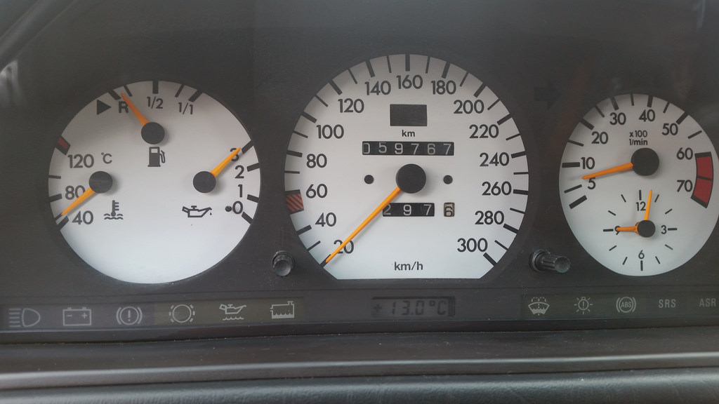

Hi everyone,
As some of you have seen, i have finally got some pics of the 500e on here.
Now i have been told the cluster is not correct (white dials and 300kmh), can someone share a photo or part number of what the cluster should be?
This is the cluster in the car at the mo
20160513_090749 by dominic jeans, on Flickr
Many thanks guys
Dom
I'm not sure about the details of your cluster; it could be one specifically for the Japanese market? There are others on this board who will know more about this.
But I am in any case attaching a pic of the cluster in my 500E. It was a Euro spec car.
Hope this helps?
P.S. Sorry if the photo is upside down!
Someone put white-face decals over the gauges. The cluster itself could be original. Only way to tell is remove the cluster and check the part numbers on the cluster and also the individual gauges (speedo, and also fuel/oil/temp gauge).
