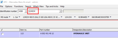

Note there are 2 different pumps involved. First is the "precharge" low-pressure pump located below the brake fluid reservoir. This provides fluid to the ASR unit itself. The other is a high-pressure pump internal to the ASR unit itself. On the M104 cars, you may not be able to tell which one is causing the fault.
Regardless, try Gerry's recommendations above and see what happens. Make sure when replacing the brake fluid that you use a pressure bleeder, required for models with ASR, and bleed the ASR unit as well per the FSM instructions.
