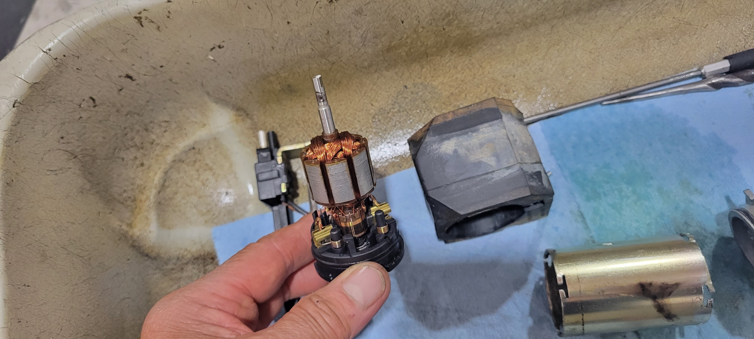

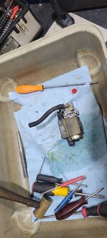

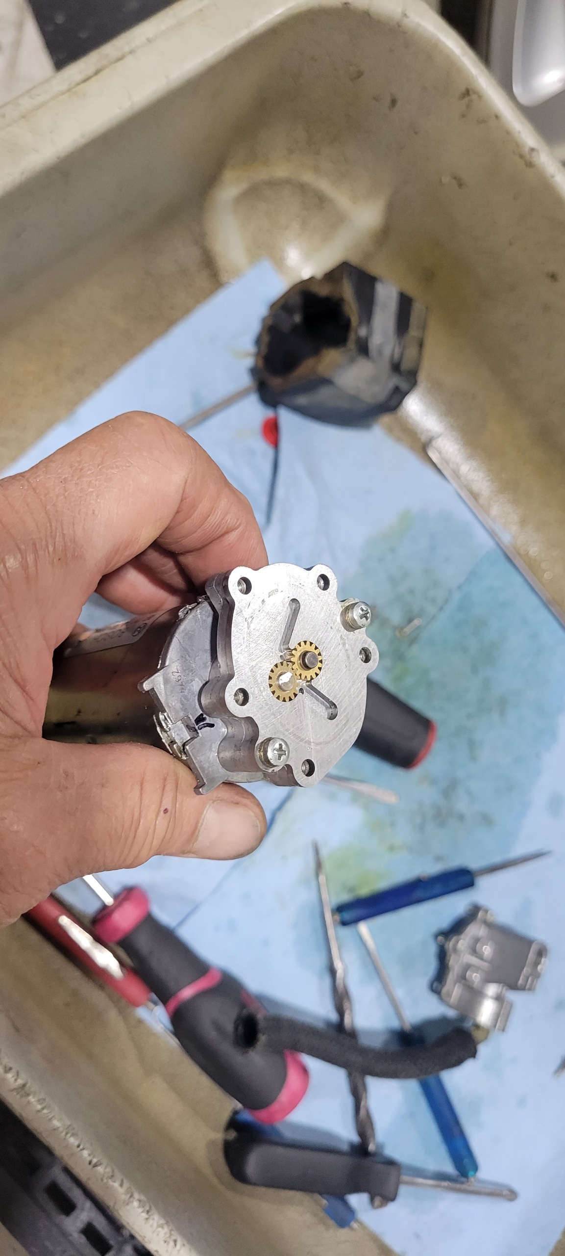

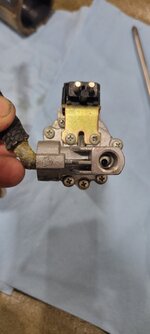

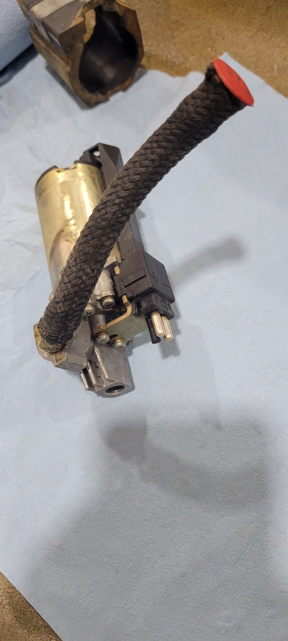

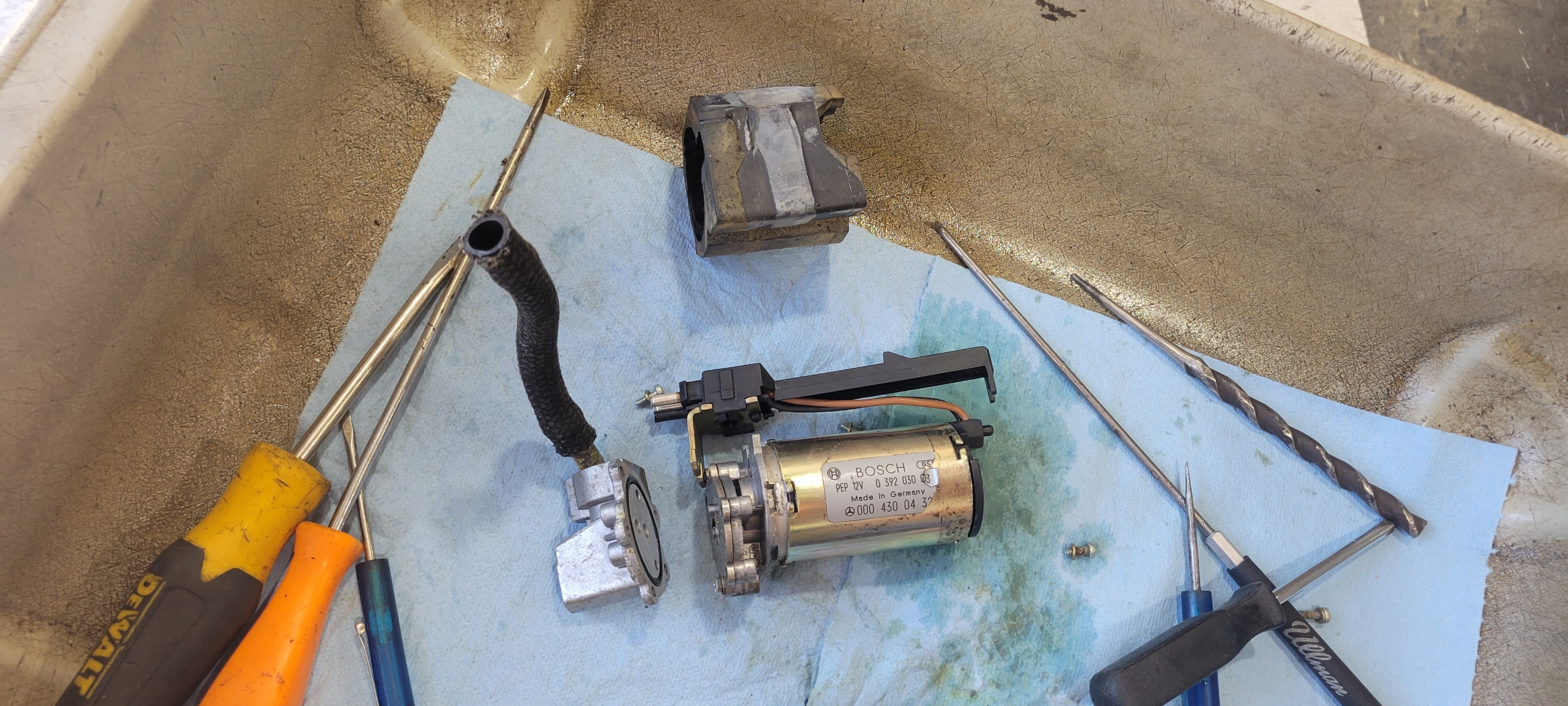

I did. Here are some of the precharge pump. It was taken apart and brushes were cleaned. The picture with the blue arrow is after cleaning. I have a video as well of the bleed. I will have to look for it.

As an aside, if you're looking to clean a motor commutator, don't use an abrasive such as emery cloth. Why? The small particles of the abrasive will come off of the paper backing while you're using it and can become embedded in the soft copper of the commutator bars. This turns the bars into little grinding wheels which will wear the brushes down quickly.
There are commutator stones that can be used on the commutator bars with the armature mounted in an electric drill. That's the preferred method.
