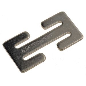

OK, I have more updates. All of this talk about car seats coincides with my son getting huge, so it was time to figure out which convertible car seat to use (he is outgrowing the infant car seat, or whill shortly). So after a while of reading reviews, and trying things at stores, I decided on this one:
http://www.amazon.com/RECARO-Perfor...d=1410548850&sr=8-1&keywords=Performance+Ride
We actually need two of them (one for each car my wife and I use daily), but my wife and I agreed that I would buy one, see how it fit in both cars, and then if she liked it, we could either get a second Recaro, or a different one.
As mentioned above, the Recaro doesn't have a built in "Lock-off" clamp, so I had to use one of these:
http://contentinfo.autozone.com/znetcs/product-info/en/US/drm/74356/image/3/
After a little bit of measuring, re-measuring and putting all my weight on the seat to get it as tight as I possibly could, I can report that it installs very well in our cars, and fits nicely rear facing behind the passenger seat. My little rear view baby=mirror thing works great, and so far so good!
