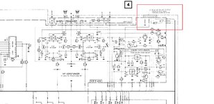

Here we go with the low level output. 1432 schematic extract:
Pins designation - please note that it's hard to judge from the drawing which one is #1 and which one is #6 - it shouldn't be a problem to figure it out on the live unit itself by detecting the +12V signal as it is either #3 or #4
NFMAS - AF ground (whatever AF means)
UBARA - +12V switched
NFSOR - AF sound right
NFSOL - AF sound left
MUTES - Mute line out (amp)
Picture of the line out socket:
Same for 1460:
There is a common ground for both channels, I'm not sure if this is going to be a problem...
