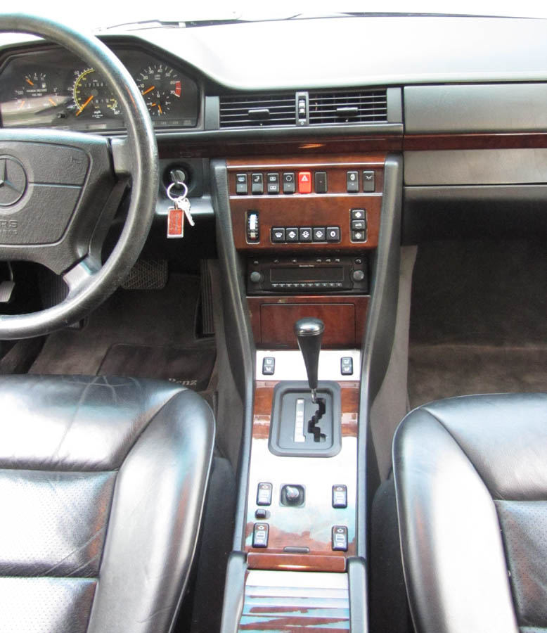

There is room, as large screens have been fit under the radio on both the W201 and W124.

Rik,
Are the HVAC controls vacuum switches or electronic which open / close remote vacuum servos?
I'd like to see something that controls hvac too with a ipad sized screen, maybe. A long ways off, but probably the only thing I don't like about these cars is lack of electronics, well and lack of a six speed gearbox. actually more power would be good, too :D
Doug
The HVAC pushbutton unit in USA cars is all electronic. It sends electrical signals to a 7-port "vacuum relay" behind the passenger airbag to control the vacuum flaps. In theory, it could be replaced with an aftermarket controller, but OMG what work to reverse-engineer it all! Yikes.

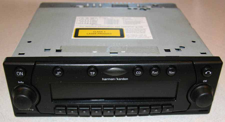

Jano...have you had chance to do any further work on this? Were you able to add an aux-in to your BE1492?
Hi Glen - not yet. I've got two of these radios, I am going to bite the bullet and send one in to Becker this summer; I just need to find where I put it; right now I've got a TP in my car.
TP = TrafficPro. There are a few variations, plus a lot of look-alike Becker units with names like Mexico Pro, Grand Prix, and some others. They all have ten buttons in a row on the bottom.
