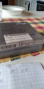

I have issues with ETA or maybe with EGAS module?

Is the issue still at throttle body, EGAS module or somewhere else?
