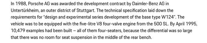

Here are a few "official" references that say April, 1995 was the month when E500 production ended:
Mercedes-Benz:
Mercedes-Benz:
Porsche Museum:
