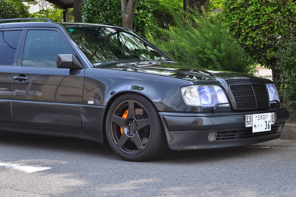

I also noticed that a lot of E500Es run Porsche calipers in Japan and I managed to find(or google) one of the companies that makes the adapter brackets for E500Es.
I sent them an email asking some questions back in July and here is what I know so far about the 996 caliper conversion.
"Type1= Front320mm / Rear 300mm (For 17inch Wheel)Type2= Front345mm / Rear 330mm (For 18inch Wheel)"

I also found some more images on google japan of w124's running on Porsche calipers. (A lot of cars were also running modern AMG calipers as well)
