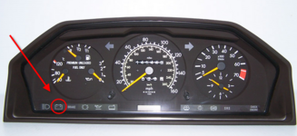

Is this the battery light you are referring to?
If so, the Canadian-spec cluster must be different... there is no wire to this bulb on USA clusters, and it's a different / larger holder as well:
Yes same battery light. But it's an independent wire on my cluster.
