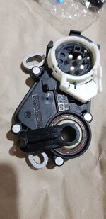

Genuine NSS in MB packet:
Note the quality control paint markings which match on the second NSS with markings ground off:
A genuine NSS should have these 2x paint QC markings.

For posterity here are photos of the genuine NSS I received in no MB bag with the part number and Star ground off.
Comparing this part to my genuine bagged switch it is identical and definitely came from the same factory.
I can only assume there is a limited aftermarket supply where this was re- boxed originally. The Ebay seller sent me the part less the box.
If any members do know for sure who the aftermarket reboxer of genuine NSS's is please share.
