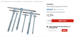

However, no such procedure exists for V8 models (400E/500E/E420/E500). So, I kind of created my own procedure. While it's not necessarily going to be 100% accurate, it should at least give you a rough idea of the engine mount condition. Basically you measure the distance between the oil pan and the frame crossmember... if you don't have a telescoping gauge as shown in the photo below, slide various thicknesses of sockets into the space and measure the diameter of the largest that will still slip through the gap easily. I'd estimate that if you measure 20mm or less, your mounts are very likely in need of replacement.
