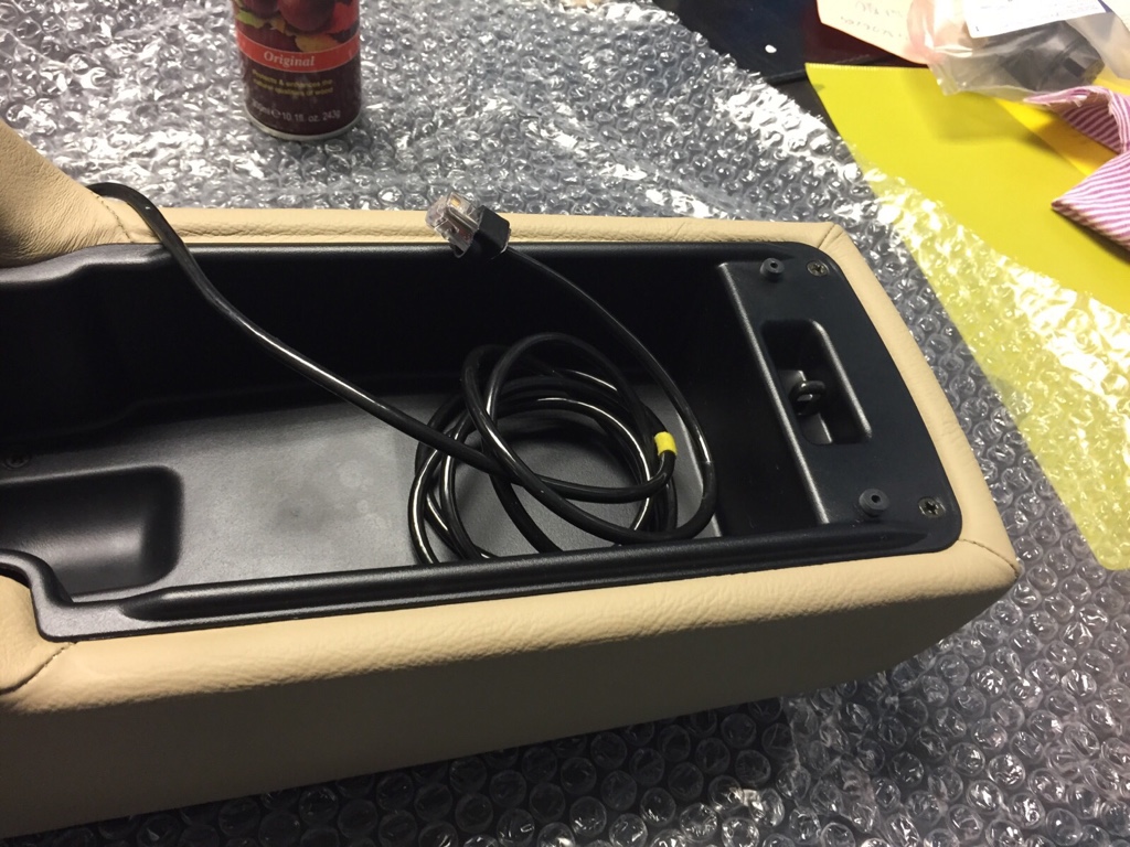

Does anyone happen to have a readily available dimensional template for the bottom part of this flip-top box? It is begging for a cork or felt adhesive lining. Thank you.
