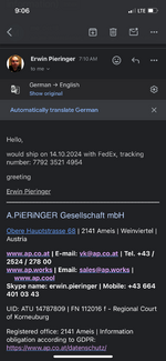

fixed!!! its just not a fan of the page translation but part has been ordered
Well emailed them asking if they had tracking (used google translate to write the email). And tracking was provided and part is stateside and about two days estimated from me.
