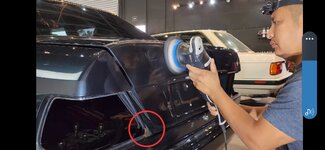

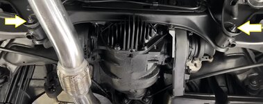

I have made no secret of my desire to get my car dry iced, but is it really THIS good? This looks fake. Someone tell me Im wrong please.
BEFORE
AFTER
I’m consoling myself by saying it’s only a matter of time before someone near to me provides this service. Until then, I wait. But availability is the only thing stopping me at the moment. As I just cleaned the leather, wheels and tail pipes on the S to make me feel good. I guess it’s a good thing I don’t have a lift because I’d be removing wheels to clean and wax the barrels.
Thanks. That looks great and is about what I expect. Everything looks really nice with a few fasteners and metal seams displaying a hint of corrosion. Not black painted fasteners.
I also thought the black painted fasteners were a bit too much. Certainly eliminates the corroded look like I have now but I try to get new fasteners when replacing a part anyway.
