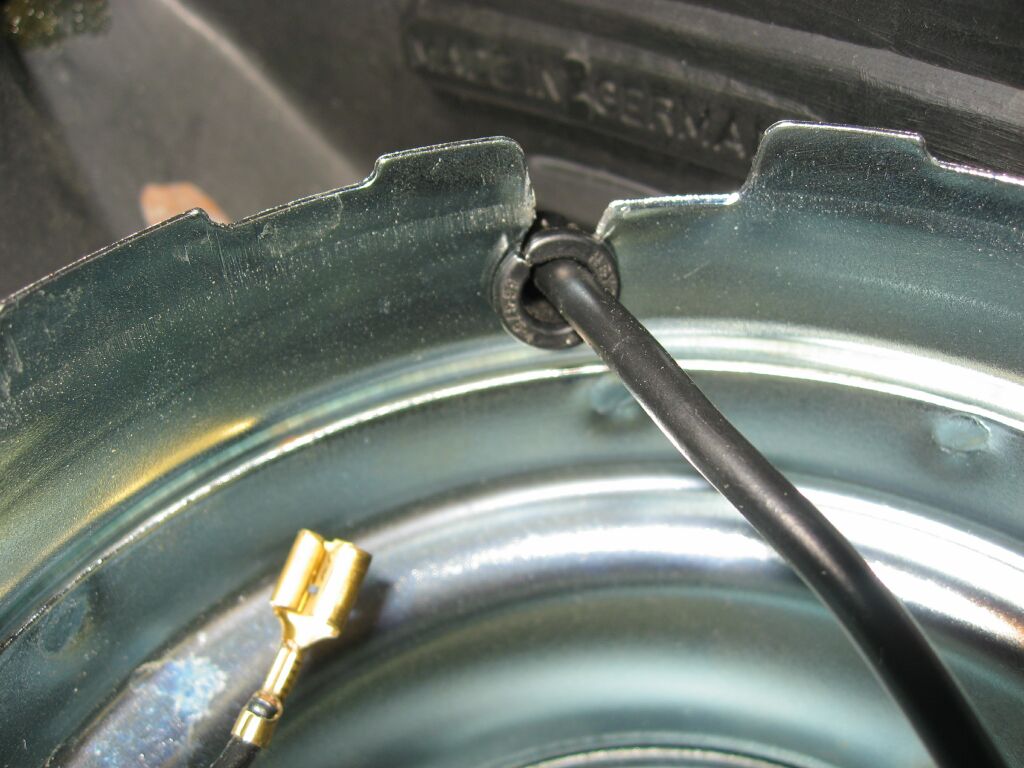

I have one in mine and have no idea how to get the horn to work
You should have two wires from your clock spring, one for the left horn button and one for the right. If you don't hook up both, your horn wont work. (the ckt wont be complete)
from the new wheel or old?
Sorry, guess I wasn't very clear in my prevous post.
I am guessing you have a 94 (based on your avatar), so since I don't have a clock spring in front of me, my info is based off of the older contact ring design.
Look at this picture.
You can see the two horn wires come out of the contact ring and are spliced together and make one connection to the airbag mounting plate. In this scenario, you need to seperate the two wires. I unplugged one from the contact ring and installed a longer wire (with new female connector) See picture below
Furthermore, the new wire needs to be routed outside of the hub area and some modification is needed to route the airbag contact wire into the hub area. You can see in the below picture I snipped a bit of metal from the hub and split a plastic grommit and routed the wire.
You then connect your two horn contact wires (one to each horn button on the E55 airbag).
