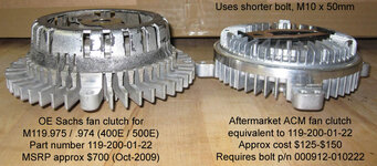

Borg Warner does not make a clutch for the 500E, AFAIK... it will almost certainly be a re-boxed clutch from a different manufacturer. The only aftermarket brand that I've had personal experience that seems to work pretty well is ACM. The ACM needs a slightly shorter mounting bolt, is engaged a bit more often than the OE Sachs, and disengages at a higher RPM. But, the pricetag (usually <$150) is quite attractive compared to the OE Sachs at $750 list. (!!!)

Yup. My only beef was the ACM disengagement RPM. I really don't like that it spins the fan about 1000rpm higher (than the OE/Sachs) before disengaging. Nobody has reported a grenaded fan blade though - yet!

Dave, I do remember noting that my ACM came with a bearing made in CANADA. Also, what RPM does your ACM disengage? Mine will turn off at 3500 tach-indicated RPMs (judged by the obvious drop in noise) if I hold the car in a lower gear.
More info about the shorter bolt. Does it have a set of specs? Peachparts doesn't mention it in their listing for the clutch.
Yeah, NONE of the vendors mention the shorter bolt (idiots!). You gotta find out the hard way if nobody tells you about it. One poor sap on a different forum broke the too-long bolt off in the fan support and then had to replace that as well - he wasn't a happy camper.
Sauceman, I check the disengagement in park with the engine at 90C or higher, to make sure the clutch is fully engaged. The OE Sachs clutches all disengage right at 3800 and they re-engage if you slowly let the revs come down to about 3200. The ACM clutch on my E420 doesn't disengage until around 4500-4800 engine rpm, which is about 5600-6000 fan blade rpm. A bit higher than I'd like, but the E420 doesn't get wound up there much.

Still researching the m10 x 50mm bolt issue. Film at 11.
Just buy a new one from the dealer (part number is in previous photo). Should be less than five bucks out the door even if they mark it up a bunch.
:5150:
News flash. Just received the spec'ed bolt #000912-010222 and it does not fit the application! Head is is too big and will not fit in the recess. Picked up a standard socket head 10m x 50mm 1.50 thread bolt at home depot and it will fill the bill. Will add some blue thread locker and, done.
If you ordered the bolt from any MB part vendors except the Mercedes dealership... the bolt head will be too large and will not fit. BT, DT. Thought I had mentioned that previously, but it looks like I neglected to mention it... my apologies!
The Home Despot bolt should work fine. No threadlocker needed, btw. Don't overtorque the bolt either. It doesn't need to be superman tight.
