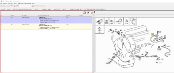

Thanks for the detailed answer again -There two camshaft position sensors in the car according to PELICAN parts front and rear of the engine,As I am ordering the parts from a country outside the US, I want to know which of the two sensors I need -part number is 0-261-210-085
002-153-13-25 - thank you
You need the REAR crankshaft sensor which connects to the EZL. Assuming you have a W124 400E, this sensor is Mercedes part number 003-153-49-28 or 003-153-50-28. Don't get a cheap one... OE/Genuine is preferred.
The front crank sensor is only for diagnostics and the wiring dead-ends into the 11-pin diagnostic socket near the EZL. This front sensor was deleted on facelift (MOPF2) models. The engine runs normally without it.
You need the REAR crankshaft sensor which connects to the EZL. Assuming you have a W124 400E, this sensor is Mercedes part number 003-153-49-28 or 003-153-50-28. Dont get a cheap one... OE/Genuine is preferred.
