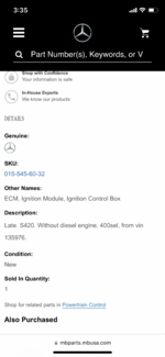

Im just replying to myself at this point but got a new coil to switch out the 1 potential bad coil. It did nothing better (was a china coil) (parts stores dont even have bosch at the distributors anymore). I looked up my EZL because it looked to have been replaced being it had yellow part writing on it and sure enough it came out of a S420. No wonder it ran like junk. Looking for an EZL now. Will post again if and when the new EZL fixes the car. Thanks for all the recommendations though.
015-545-60-32 is for a 4.2L engine.
015-545-61-32 is for a 5.0L engine.
Any time a previous mechanic has been monkeying with things, I like to confirm the part numbers in the car are correct (mentioned back in post #5). Years ago I bought a car that was not running properly. Turns out the previous mechanic had swapped in a wrong throttle control module in place of a defective module and there was no change, and he didn't know what to do. The owner had given up and I got a good deal on the car. I swapped in a good, correct module and the problem was solved. Gotta check their work!
The photo of the EZL you posted would be correct for a 5.0L engine, not sure if that is of your car?
:watchdrama:
:watchdrama:
My car is a 1995 SL500. Its been a long day. In talking to someone at Mercedes, yes the EZL matches up to the car. It might have worked but supposedly unplugging any ignition device while the car is on ruins it (I unplugged things so it may not have worked when I got the car but 100% doesnt work correctly now), live and learn. I bought an EZL off Ebay, the seller has a good ratings and accepts returns. A lot of sellers dont accept returns or have bizarre return policies. It was $220 without tax. Here is another picture of my EZL, as you can tell it more then likely has been replaced before. Who knows if it was known working though. Ill post again when I get the new to me EZL. Thanks again
