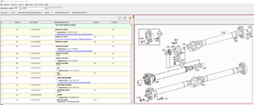

I think I may actually already have the thicker flex disc, last time I replaced both I found out that to my surprise factory manual w124's have a specific flex disc i assume to accommodate more driveline vibration? That was my assumption at least when the dealer told me its a different part... just found a 91 CE being parted out not over 100miles from me though :jono:
EPC shows the same flex discs for both auto and manual trans in the 300E. The difference isn't thickness, it's diameter. Discs for higher-torque applications are larger diameter. I think the sizes are 80, 90, 100, and 110mm bolt circles. But I'm not sure which sizes are used on which chassis. See FSM job 41-050.
However, the EPC does show the front driveshaft is different between manual & auto... could be a length difference, in which case the late sedan shaft might not work after all. LA = auto, LM = manual.
