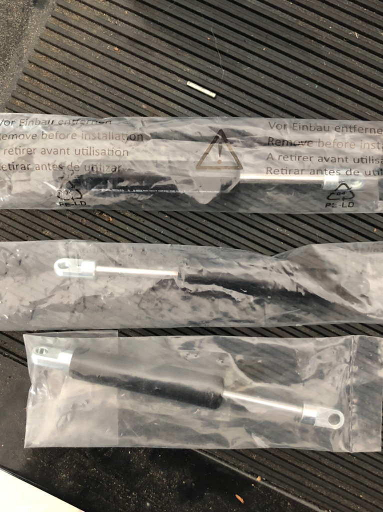

Here are some comparison photos of the ivanned struts with the Triple-Trouble Stabilus struts.
A few differences:
1) The screw-on ends are near-identical between the struts, though the Stabilus strut ends show threads on each side. The ivanned ends do not show threads.
2) The screw-on ends seem to be interchangeable between the ivanned and Stabilus units. Meaning if you have previously installed an ivanned strut, you can re-use the ground down screw-on end on the Stabilus unit.
3) The Stabilus struts have a fixed other end at the bottom of the hydraulic cylinder. The ivanned struts have a second, screw-on end that goes into a threaded shaft. This second screw-on end is identical to the end piece that must be ground down.
4) You can see the lengths/dimensions are slightly different, though the overall dimensions are pretty much the same.
5) The Stabilus strut appears to be a bit stiffer “out of the box” than the ivanned struts.
Photos attached. I’ve now got three unused struts in my parts stash.

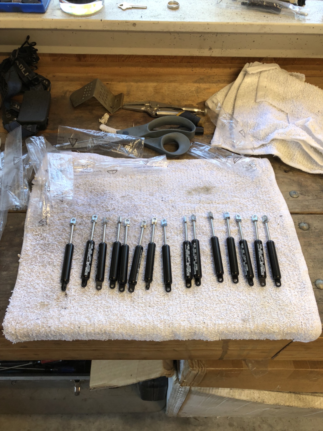

Photo of everyones struts ready to go, and waiting on the straps.
