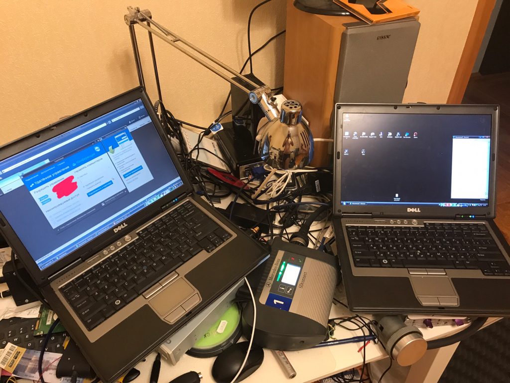

For old w124's it's more than ok to have c3 with emulating HHT(hand held tester) with dell d630.
Just to clarify -latest software with HHT is 2014/09 xentry
