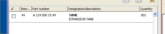

Here's what the description for the highliged part looks like, on the left side of the screen.

And here's what the full EPC screen looks like with a part number highlighted, and the part description showing for that part on the left side of the screen.

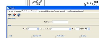

Here's a close-up of the Search window that appears. Click on the second tab that reads "Part Without Vehicle Data"
After you do that, you'll see the window change format, with a white blank with an "A" at the beginning of it. This is where you will type in the specific part number you are looking to cross-reference across MB models. As our first example, let's use the above-mentioned 500E/E500 coolant expansion tank, which is part number 124 500 15 49.
Type that part number into the search box, as shown below. Leave the "A" in place, and type the part number AFTER the "A." Then hit the "ENTER" key.
