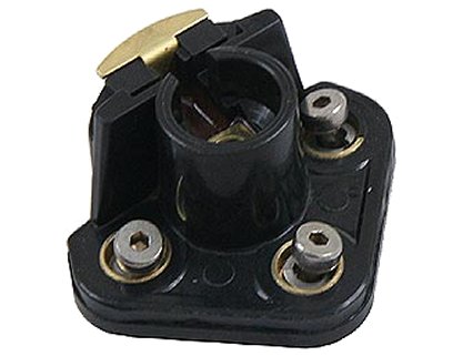

I ordered 4 Bremi caps yesterday and was wondering which of these rotors fit our cars, and can they both be used with the Bremi caps?
Makes
[TD="class: product_main, bgcolor: White"] 04271 Bosch OEM - Distributor Rotor
For models with updated bracket 1191580640 (Bosch 1230328037). It cannot be used with previous bracket 1191580440. 2 per car.
View Details
$34.45
SALE$35.89
List: $83.00
Qty:
[/TD]
[/TD] [TD="class: product_main, bgcolor: White"] 1191580331A Bremi - Distributor Rotor
2 per car.
