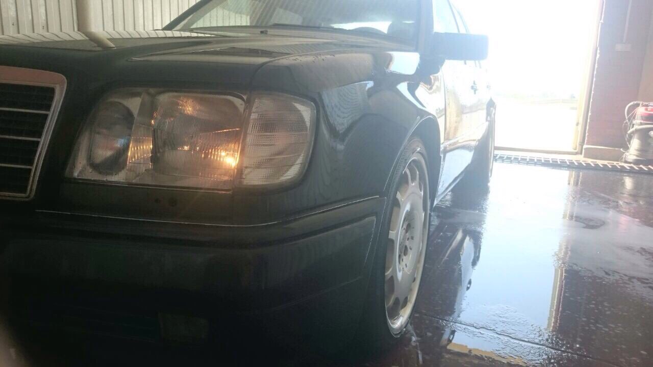

So this is the stance the car has always had since I bought it-
Way too low at the front end. It’s running 1 bump pads both front & rear. I have a brand new pair of 3 bump spring pads on the shelf so they are going in. I think that will level it out & I’m not a fan of the ‘slammed’ look anyway. I think with the 3 bump pads up front the suspension will be sorted. The extra 10 -12mm up front will make all the difference and it will still handle well with the E60 kit underneath.
Check out the pic of another E60 compared to my 500E, It’s got the exact same stance :scratchchin:
