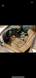

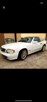

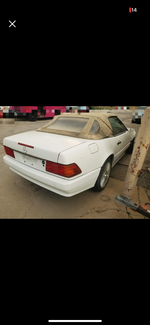

Actually, it came wrapped in a 1995 SL 500 that had been abandoned at a shop with 123,000 miles on it. It does power up, but does not crank over currently, but the shop assured me that it ran and drove when it got there in 2018. we will see lol nonetheless, are the wiring harness is the same? I haven’t gotten a code on this one but my suspicion is that it is original. I’d rather use my updated harness if possible. The SL also has ASR, and my car does not. I would assume that I can swap the 4.2 throttlebody actuator over to the new 5 L engine? I already have a newer rebuilt sun valley 400e trans- is there a pro/con to using the sl500 trans? Ideally I’d like to swap over my eight rib pulley system, to work with my new AC compressor. Is that possible on the 119.972 from the 119.975? Is there any programming necessary on these LH module? I also plan on a full exterior reseal and checking of the timing chains and guides in the process.
