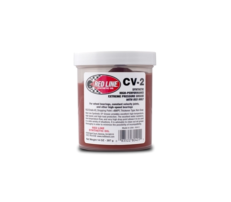

FWIW, we have started taking our old/early LCA's stripping them down and powder coating in semi gloss...ordering up Genuine bushings and ball joints there by building "new" LCA's. If you have a late car or SA brakes it Does get tight, but with some careful removal of casting slagg I've always been able to make them fit. Worst Worst Case I've put a small hole in the dust shield.
Also, on our joints we're pulling the boots on the ball joints and replacing the original grease with Redline EP. That stuff is magic when it comes to making metal things Last.
