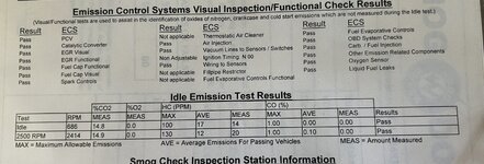

My final attached..... Good for another 2 years.... Can hardly wait!!
Hopes this helps someone and saves them some frustration....... Woodman
