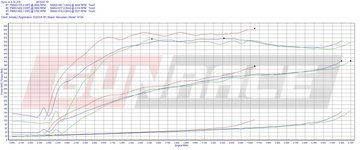

Already tested AMG and Brabus modules.
stock module with WOT - 375HP
AMG - 402.3HP
Brabus - 402.1HP
AMG - 402.3HP
Brabus - 402.1HP

stock module with WOT (...1732) - 5.0L module
copy of original AMG and Brabus modules were tested
regrinded camshafts were used

Cool! With that setup, I think 400hp is probably the best you are going to get. Nice work! Have any photos or dyno graphs?
Also, what size intake valve was used? Standard 38mm? I'd love to do the same conversion...
:wahoo:
the gearbox can't handle the increased torque and its visible on dynograph
new gearbox and torque converter will be tested this summer
