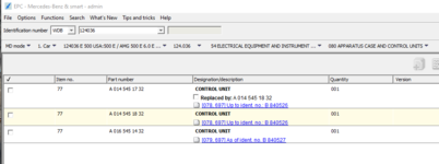

The latest EPC only shows the "last" part number specified for most chassis with LH modules. However, old EPC's as shown below, display the old part numbers with supercession chain. Second image has the footnotes.
Hello all - sorry to dig up an old thread, I wanted to confirm whether 014 545 18 32 is a WOT enrichment module or not? It states on the Wiki it is an original 140 part then used as a 500E part, but not clear as to whether it is WOT enabled. Many thanks!
Yes, it has WOT enrichment. And, the EPC / XPISS shows this module as replacing the 014-545-17-32 which originally was installed in late-production 036's with WOT enrichment (i.e., late 1992 USA model year). VIN break for Euro-spec cars shown below in EPC screenshot:
