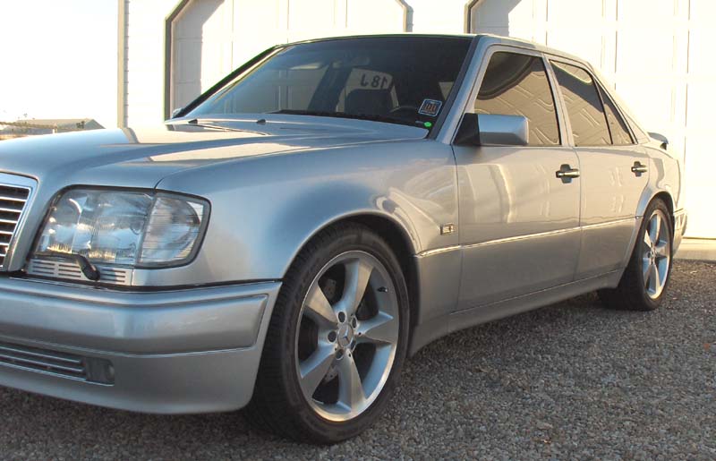

Glen is correct. These fit, but need spacers to properly fill out the wheel well... and also need custom lug bolts with R14 ball seat. But yes, they will bolt up without issues, no rubbing... I bought a set years ago for the new tires mounted, kept the tires, and sold the wheels:
