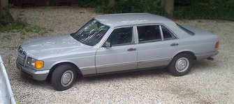

Nice thing is that my replacement car is fun, too, see attachment :) It's a 500SEL from '84 with 106k km on the clock. Engine humms even better than my 500E and is unhearable if it's in neutral.
