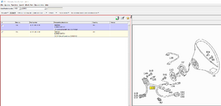

Can’t seem to find this part no. in the EPC. Number on old unit is 1245450424. Is this still valid? I do have a new unit with part no. 1245401045 but it is missing the horn contacts. Would a new unit for a 1992 come with the horn contacts or is there a way of swapping the contacts from the old over to the new unit?
1245450424 is in the EPC for other chassis, but not the 036. Appears to be for early-build 124's only. Could be either there's a supercession not showing in the EPC for the 036, or your combo switch was replaced in the past with a "wrong" one.
EPC shows A1245401045 as correct for a 1992 500E.
The horn contacts (2 brushes) in the steering column DO NOT come with the switch, those are separate. I can't seem to locate them in the EPC. You should be able to swap them over.

In the EPC diagram above, horn contact is callout #125, part number A1264641043. Grab the white part with some needle nose pliers and give it a firm tug, it'll pop right out.
Thank you very much for that useful information 👍🏻. I just ordered the horn contacts at the local dealer, delivery time 2-3 days.
