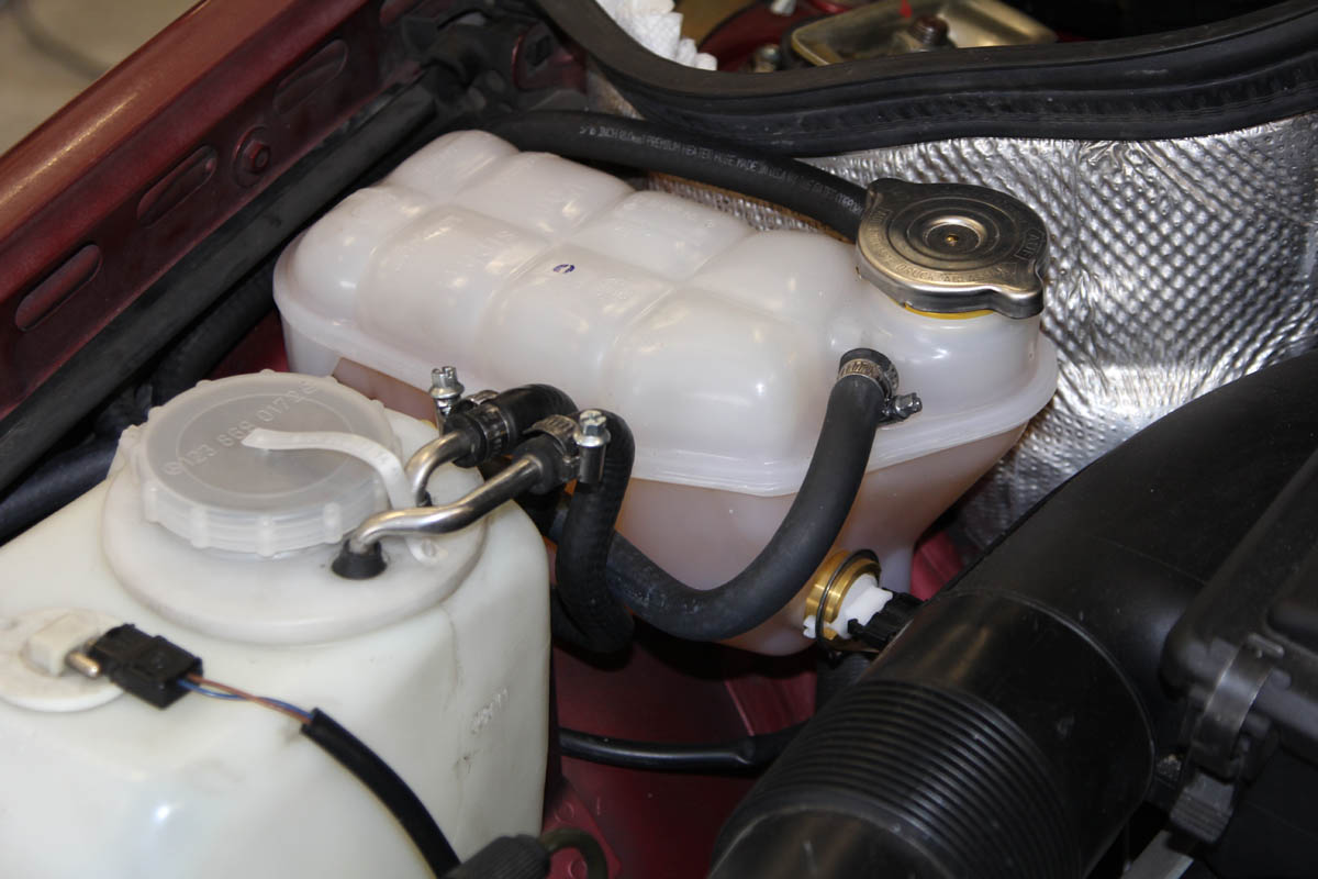

The washer pumps look ok to me... pic below. Relocate that coolant aeration hose below the fender line so the hood doesn't pinch it.

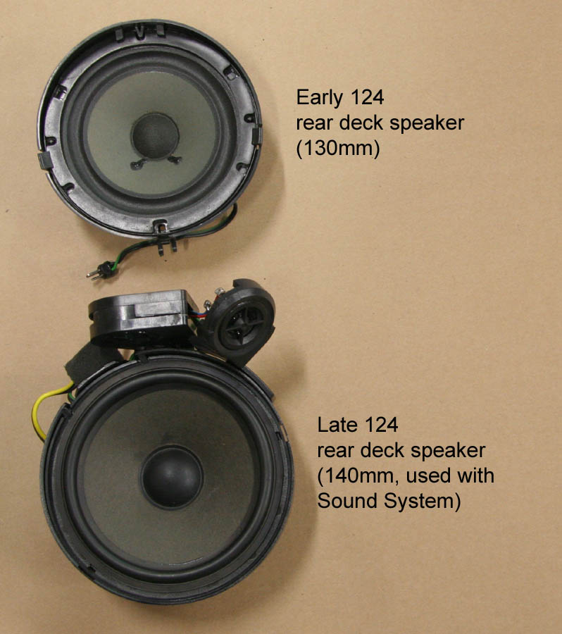

Have to replace the speakers they're cracking. I think the rainbow ones would be better than the MB ones surely tech has come a long way since 1992?!
One of my rears failed too... I replaced it with a good used one. Speaker technology has improved since then, but not drastically. Rear fill is not as critical compared to the front soundstage. I think new ones may be NLA, so your only option would be used.
Factory rears have a 140mm driver (not 120mm) and are 2 ohm, not 4 ohm. Not easy to find a 'correct' replacement. Additional photos are at this link.
Hi all - not updated this for a while but progress has been made. Getting to know the car / enjoy it more and certainly enjoying it. It could handle much better but I think replacement of the front shocks and all the bushes underneath can help. Traction control sometimes hinders experience but the ASR defeat from Martin will help this. Work completed is the following plus a few small bits and pieces I've probably forgotten about now:
- discs and pads replaced (MB)
- washer bottle and all accessories
- 245/45 and 265/40 bridgestones fitted
- number plates replaced
- LED plate bulbs added
- aux fan resistor replaced
- coolant reservoir replaced and accessories
- coolant upper hose replaced
- SLS reservoir replaced and fluid topped up
- number plate lenses replaced
- fan belt replaced
- fan belt tensioner replaced
- coolant sender level replaced
- headlamp washer system fixed (connector replaced)
