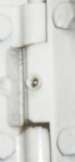

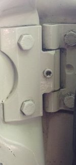

This is what a 126 hinge looks like. Note the ball bearing grease point, which requires a pointed/cone/chain saw grease tip.
A standard Zerk grease tip WILL NOT work on this type of fitting, as it requires the ball bearing to be depressed inward for the grease to be injected.

the W124 DOES NOT have this type of grease point.

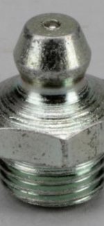

Here is what a Zerk fitting looks like, which is accommodates by the standard tip of most grease guns. Not present on the door hinges of the 124 or 126. Though they are all over the underside of my G-wagen!!

That grease fitting is not unique, is still a standard grease fitting but used much less, especially where available space or interference is the issue (is also known as "flush-type" grease fitting, German standard DIN 3405). You can still use a regular grease gun but you will need a "needle-nose" adapter. Here is an example:

Correct. Basically what I was saying. A cone-shaped adapter also works, which is what I use. Many people also use chain saw lubricators too.
The point I was trying to make was that the 124 does not have this type of grease fitting (Zerk or flush).
