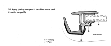

Agree on the 3M glazing and bedding compound. It stays pliable forever, no crumbly stuff, etc. It is messy though, so mineral spirits or acetone is great for cleanup. I used it to seal my wagon's rear side windows after I took them out and got new rubber seals for them. The MB writeup specifically stated to add their version of the sealant between the body and the rubber seal, and also between the rubber seal and the glass. The old MB stuff was crumbly and I had the famous "fogged up windows" in the morning and it was due to these seals. The point I'm getting at with the wagon is that I'm going to apply the same concept to my sedan, and here's why:
I always learn something new on this forum. Now I know why my 400E was rusted out around the rear glass! When I had my glass replaced 2 times, no one even knew to use the glass compound on the rubber seal... It is clearly stated in the FSM to use it. Now, when I get my glass installed again, I need to make sure that they do it like this. Otherwise, it will rust again.
Absolutely correct! The FSM calls it out.
