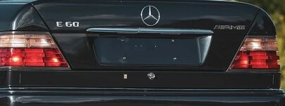

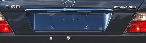

Hello Folks...My E60 just arrived today. First order of business is license plates. How can I mount a US plate on this car.
Attaching the pics of what it looks like. Even the screws needed are different.
Found this thread below but kinda got lost in it
Thank you in advance!!

I don't know of any bracket that's sold. I always had them with the car and last time around I kept one from a euro car I sold. It looks identical to URO 01142. You can drill through the plastic frame and screw into the existing trunk holes that way. I can send measurements of how mine is if that helps. The inner bolts are ready for the US plate and I just got some fresh screws from Home Depot.
