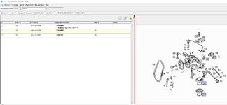

The rubber sleeve alone, 110 186 00 07 shows no MB stock anywhere in the world. The sleeve together with screen assembly subs from 110 180 03 55 to the 601 180 01 55. There are at least 70 available of the 601 180 01 55. Yes, I know it looks different. Don't worry about it.

When I searched this issue for this thread recently, there was no stock for the 110-180-03-55 shown anywhere in the world. The EPC clearly shows the 110-180-03-55 being replaced by the 601 180 01 55. The MB parts inventory system showed lots of those available. Well, we’ve seen what happened, as Steve119 reports that the 601 part number is only the screen without a suction tube. Interestingly enough, that same inventory system now shows some of the 110 180 03 55 available.
Go figure.
Now, interestingly enough for those of you using terms like “new version/old version/updated”, please be advised that the largemouth 110 version WAS the early version of this part as far as internal diameter size goes. It is from the M110 twin-cam six engine that went into production in the early 70s.
The 116/117 and subsequent V8 engines got the smaller ID oil pick up considerably later in thier production, IIRC, around the time that they switched to KE injection and EZL ignition, along with a host of other changes in late ‘85, but it may have happened shortly before or shortly after that, and they obviously continued with that smallmouth version at least until some point in the 119. It looks like they were even using them interchangeably for s period.
SO, now at least for replacement parts, it looks like they have fully REVERTED BACK to the earlier larger I.D. suction tube(?)
Not that I think it matters one way or another, but if somebody actually wanted the smaller diameter opening tube that they may be pulling out of an engine, it looks like that MAY also still be available with the part number 102-186-00-07. I can’t say for sure, and I’m not curious enough to order one to find out. I’m just glad to know that the most obviously non-potentially restrictive 03 55 has apparently bubbled to the top of the inventory system. Hopefully it won’t totally disappear again...

The original part number for the rubber boot (without screen) is still available, now with a -64 suffix: 110-186-00-07-64
Naperville confirmed there is inventory in USA. $18.50 list, ~$14 discount. I have one on order and will report back if there is a COO on the label.
:detective:
110-180-03-55 is the metal screen only, which was superceded to 601-180-01-55... this may be available, if you need it?
The rubber boot / pickup is 110-186-00-07, glad that is still available, for now.
