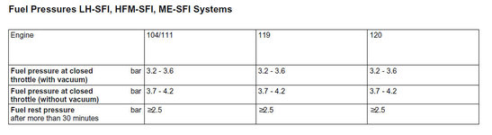

Very roughly, fuel pressure with engine running should be 46-48psi with the vacuum hose connected, and 56-58psi with the hose removed. When the engine is turned off, wait 30 minutes and the pressure should be above 35psi (if not, the fuel pump check valves may be leaking down).
See attached for official specs from FSM.
